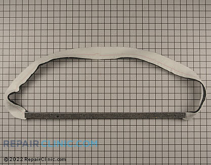

Sears Kenmore Dryer
2001 Sears Kenmore Dryer made by Whirlpool(model#11062722101): Making a thumping sound, I found the Front Drum Bearing and Seal assembly broken, Part#3406129
Front tub glide bearing and seal assembly
