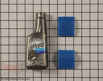

Smooth/Glasstop Range Cleaner
Range Top Cleaning Cream. For used on smooth top ranges with black or white glass ceramic tops, stainless steel and chromed surfaces. Removes most cooking soils. 20 oz bottle
Range Top Surface Cleaner
P/N: 20001070
You can click on this Logo Link below for more Appliance Parts
