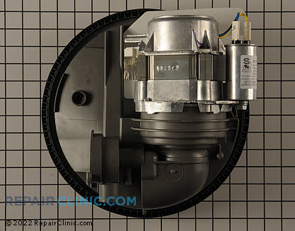

Also this recall on this model called for a new Motor/Pump Assembly, I installed a new Motor/Pump Assembly, Part#8194160
PUMP&MOTOR
P/N: 8194160
