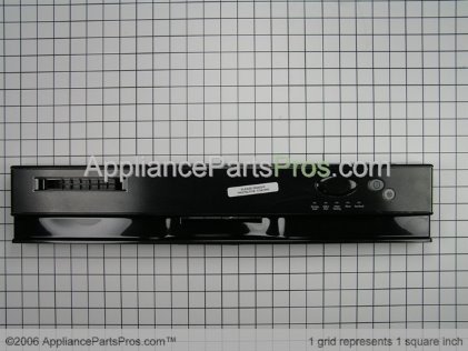

Control Panel
2001 Kitchen Aid Dishwasher(Model#KUDP01DLBL0): Push buttons on the control panel not starting the dishwasher cycle.
This control panel color is Black, it also comes in White, Biscuit.
Part#8531251(for the Black Control Panel).
KUDP01 Series
