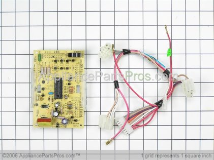

Sears Kenmore Even Heat Control Board
1997 Sears Kenmore Dryer(Model#110.68932790): When you push the start button it starts and runs, when you release the start button the dryer stops and will not continue to run. There is a service sheet inside the top control console, it gives you step by step troubleshooting instructions. On this dryer, the even heat control board was bad.
Part#279903
