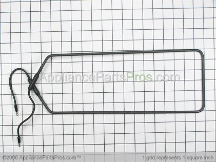

Frigidaire Refrigerator Defrost Heater
Frigidaire Side by Side Refrigerator(model#FRS20ZSHB3): Not cooling properly, found the defrost heater bad, it didn’t ohm out for continuity and it had a bad pit spot in it.
Here’s the defrost heater for this model:
Manufacturer’s Number: 218657301
