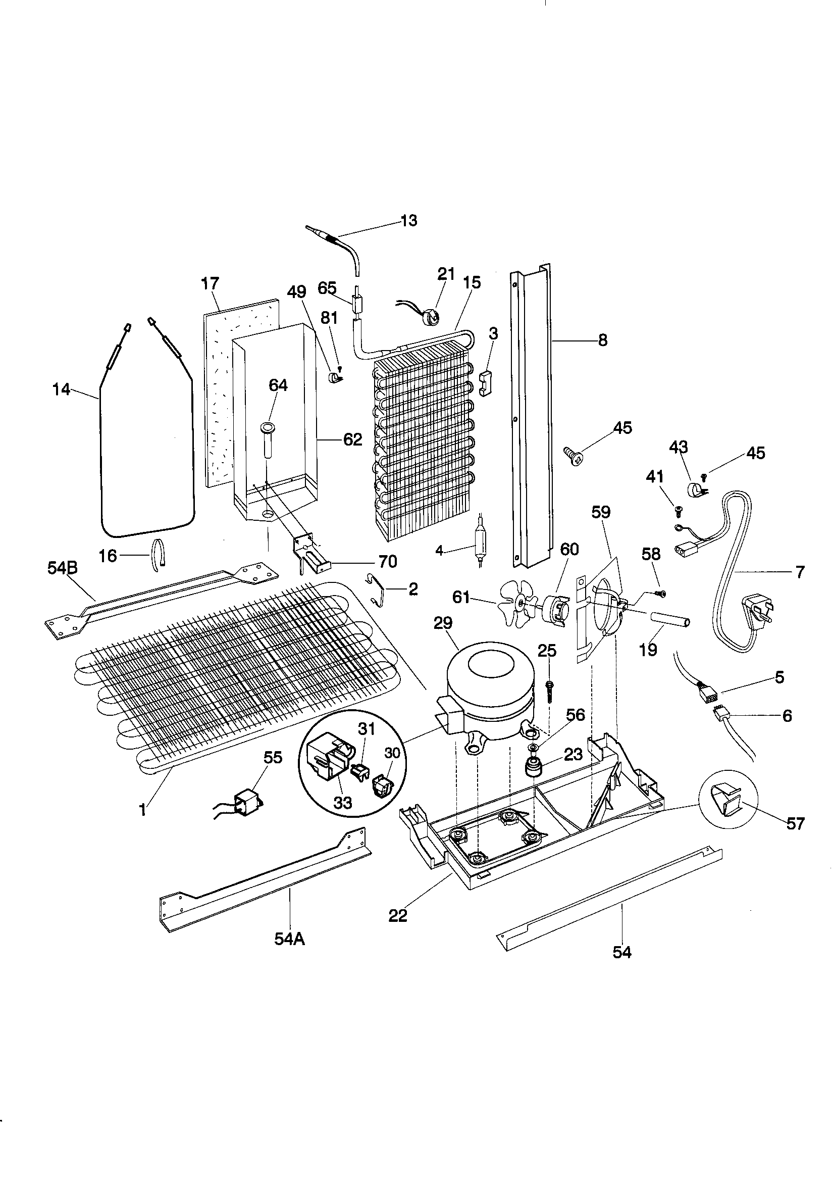

I have a Frigidaire model FRS26ZSHB0 that is not cooling the refrigerator . I posted this before and it was diagnosed as a defrost timer problem. It takes about 3 weeks to frost up after defrosting it manually. But I have replaced the timer with the part recommended. Please help with this. What is the next step?

Then the problem is the defrost thermostat is intermittently working/not working. You would need to order a new one.
Here's the defrost thermostat for your model you can order:
Manufacturer's Number: 5303917954
5303917954
Its #21 here, it clips on the top of your evaporator coils:
http://c.searspartsdirect.com/lis_png/PLDM/P9050101-00006.png
