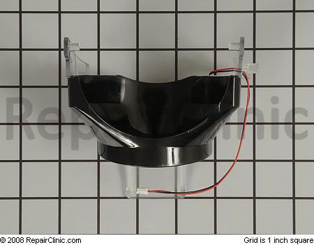

Its not uncommon for the water dispenser actuator and ice dispenser actuator to go bad about within the same time, I think thats the issue.
Did the ice door flap issue happen at the same time? or has that been an ongoing problem?
Here's the ice dispenser actuator for your model:
Manufacturer part number 241682303 is RepairClinic item number 1196660
241682303

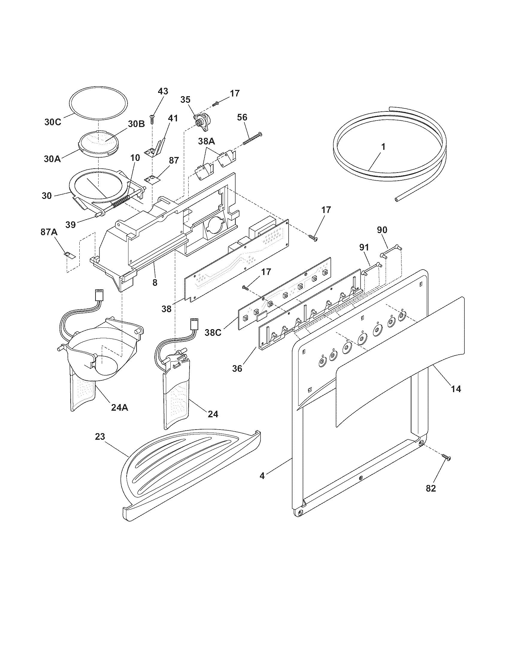

Old October 15th, 2009, 02:21 PM
Posts: 30,227
Quote:
Is the dispenser lever the piece you press the glass against to dispense the ice.
Yes,
You're going to need to get into your dispenser assembly and physically see what may be the issue.
Here's the parts diagram:
http://c.searspartsdirect.com/lis_pn...6104-00007.png
