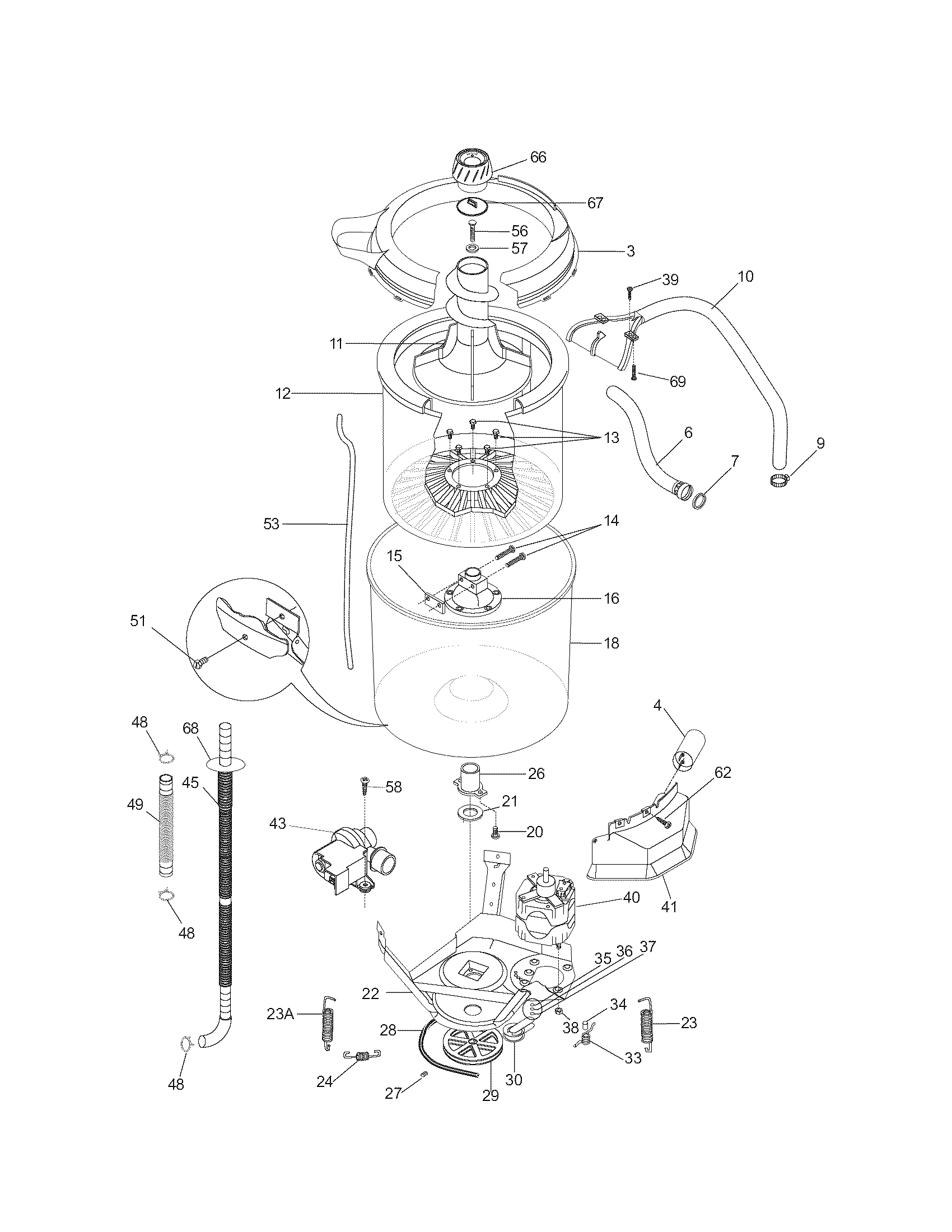

    Model Number: fws1233fsi
    Brand: Electrolux
    top half of agitator comes off (maybe worn), but can be reset on top spindle of bottom half of agitator. now the machine agitator will not function, but will spin,drain all other cycles work ok
    55,492
    59
    Thanked 3,146 Times in 3,124 Posts
    Sounds like a bad drive block.
    Here's the drive block for your model:
    Manufacturer part number 134418700 is RepairClinic item number 1170670
    134418700
    Take off #66 and #67 here:
    http://c.searspartsdirect.com/lis_pn...0122-00005.png
    Then you will see the bolt that holds your agitator in, just remove it and the agitator will pull up, then you can see if the drive block is stripped on the transmission shaft.
    Also you'll need a new agitator to fix the top part from coming off issue.
    Manufacturer Number 131605901
