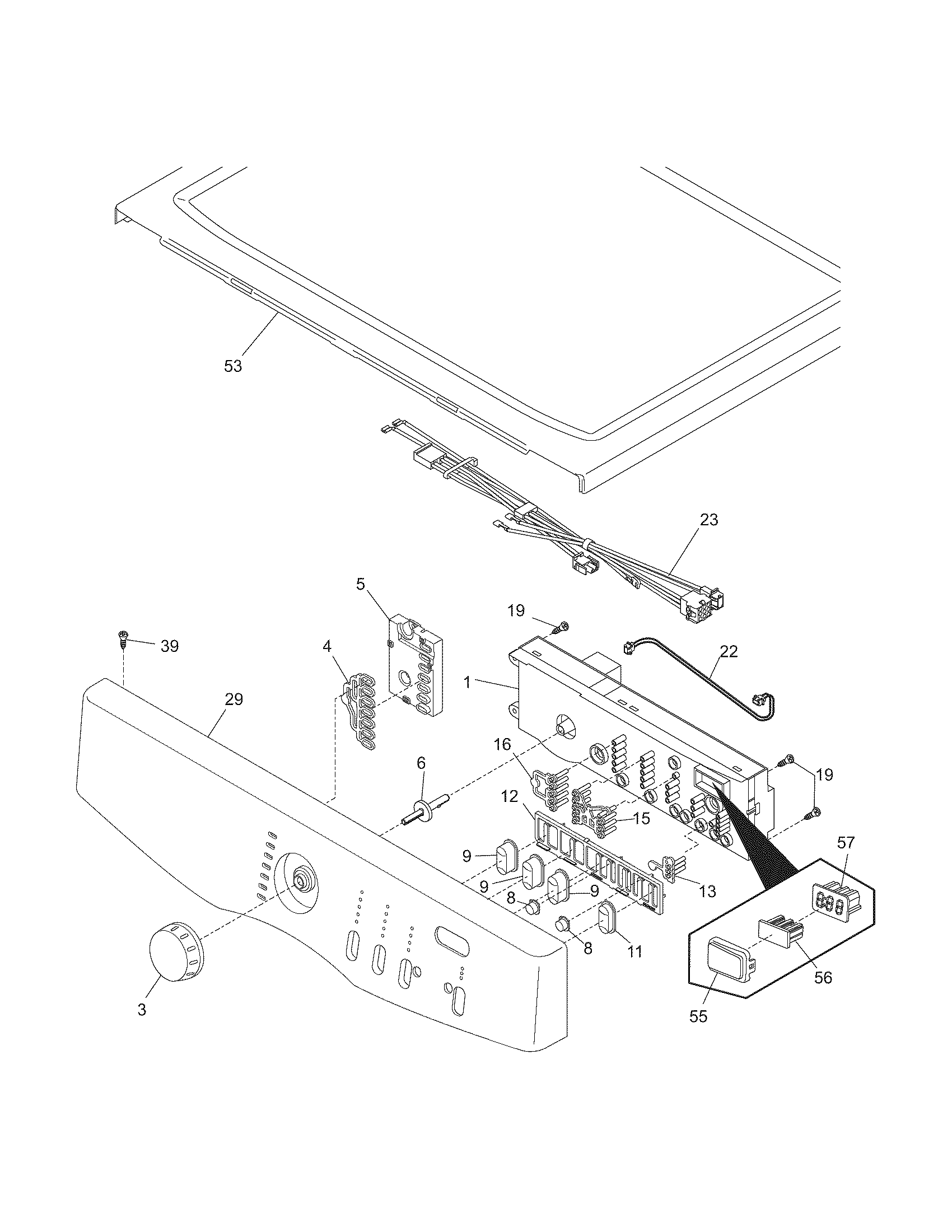

    13,695
    Couple screws on the back of the top panel and it comes off. You'll see the screws for the control panel. Remove them and the console comes off . Two screws holding the the top of the front panel and it lifts off.
