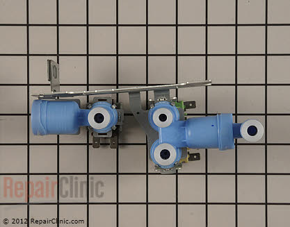

    Yes, I've run into this problem a few times after I replaced the diode kit as well. You will likely need to replace the water inlet valve too, thats what I did, and it worked great.
    Water Inlet Valve 241734302 Order now for same day shipping. 365 day return policy. RepairClinic.com

    Got the water valve locally, installed it this morning and it works flawlessly!!! Thanks go to Rick and Jake for your advice!!! It is very much appreciated.
