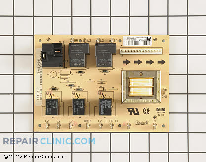

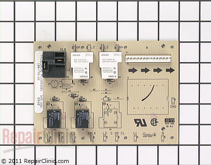

    Without checking any voltages, I would say it's a relay board issue. It looks like there are two relay boards for your unit, one for each oven. I would buy the board for the oven used the most. If it worked and the oven operates correctly, I would take the broil relay off of the board you just replaced and replace the bake relay on the other board with it. If it works, you'll save around $150 but it requires a little bit of skill in the soldering department. Here are both relay boards:
    Relay Board 318022001 Order now for same day shipping. 365 day return policy. RepairClinic.com
    Relay Board 318022002 Order now for same day shipping. 365 day return policy. RepairClinic.com

    Decided to replace only the upper control board. Which one is for the upper oven?
