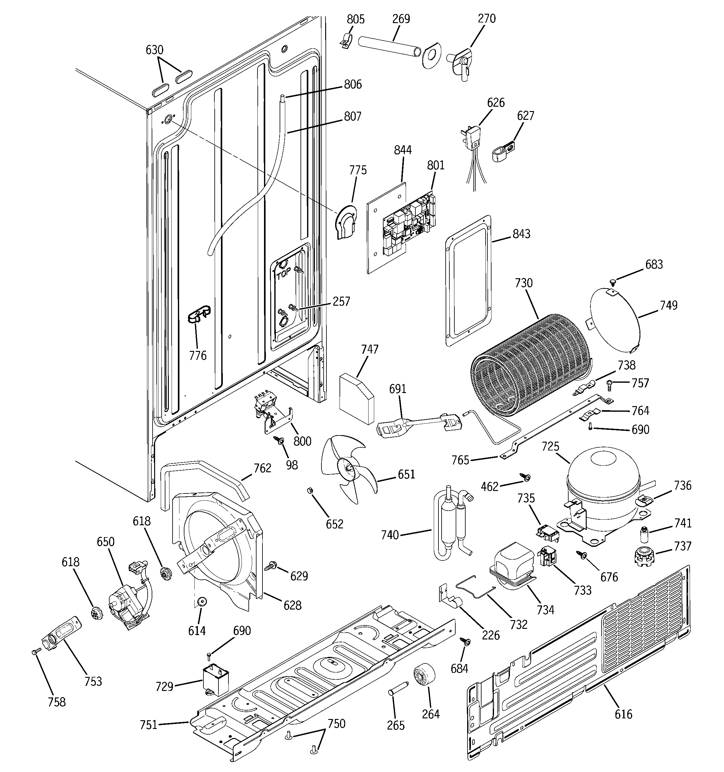

My GE model#(GSL25JFPEBS) will make ice fine, but will not dispense ice. The water will dispense through the front as well, but when pressing crushed or ICE, neither will dispense.
The motor does not turn, and the solenoid does not raise(near motor) for the trap door in the tray to open. The trap door does open in the front door itself.
When I test voltage on the board, I get 120 to the water, 39.6 to crushed, and 39.6 to the auger. Is this correct? shouldn't they all be at 120 while the switch is off?
Once you try to dispense each(water, crushed, ice), they all will drop to 0. Could a relay hold down voltage? After reading a lot of these issues, I am assuming the relays(ZETTLER AZ9431-1AH-12DE) on the mother board are bad, but the difference of voltage is confusing me.

Its likely the motherboard thats causing this issue, we've had alot of members with this same issue and the motherboard is the problem.
You should be getting 120 volts to crushed and to the auger.
Your motherboard#801 here:
http://c.searspartsdirect.com/lis_png/PLDM/H0312163-00008.png
is in the back of your refrig. Take off that metal cover#843
Unplug your refrigerator first!
Here's the one for your model you can order:
Manufacturer part number WR55X10656 is RepairClinic item number 1266104
WR55X10656

Ok, got the board in and replaced it in 5 minutes. It was not the board.
The trap door in the door opens when the dispenser switch is toggled, but not the one on the tray and the motor does not turn.
Where do I go from here?
