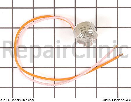

Jake, I have a GE PSS27SGPA FRIDGE. The temp. is perfect in the fridge. The temp in the freezer stays at 21. I opened up the freezer panel and the coils are all frozen. What could this be? Thanks Ron

The way I test the motherboard is process of elimination, if the evaporator coil in the freezer is all frosted up, by doing a ohm test for continuity first on the defrost thermostat and defrost heater, if those both check good, then the motherboard would be the bad part.
You can ohm the defrost thermostat WHILE ITS FROSTY for continuity and the defrost heater as well.
It may be the motherboard, as GE has had alot of issues with this going bad.

Here's the defrost thermostat for your model:
Manufacturer part number WR50X10068 is RepairClinic item number 1170024
WR50X10068
Your defrost heater is #230 here AND defrost thermostat is #240:
