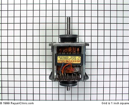

I have a GE dryer that needs a motor switch. Do they sell just the switch like Whirlpool? Model# DVLR223EV0WW I see the motor switch is burned out.
Thanks John
Old October 13th, 2009, 09:15 PM
Posts: 30,214
Unfortunately they don't make the motor switch separate on this model.
Here's the motor assembly:
Manufacturer part number WE17X53 is RepairClinic item number 275457
WE17X53
You would also need to order the related item 2283 if your motor pulley is welded on the motor shaft.
