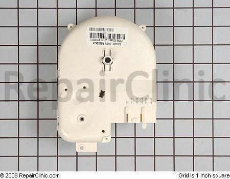

But If the lid switch checks good, about the only part left the controls the motor is the timer.
Here's the timer for your model:
Manufacturer part number WH12X10348 is RepairClinic item number 1264499
WH12X10348

Does the timer control the spin seperate from the fill? Because when the spin and drain cycle is on, the pump turns on but it doesnt spin... I think I am gonna just send the part back and send this machine to the trash can
  #6
Old November 5th, 2009, 08:40 AM
Posts: 30,221
Yes, the timer does control the spin separate from the fill.
