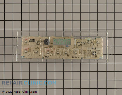

    63,669
    If no 120 volts, then here's the clock oven control board for your model you can order here:
    Manufacturer Number WB27K10354
    socalguy013 is offline Premium Member
    Jun 2012
    San Bernardino, CA
    So you think that's what the problem could be? Even though the broiler still works?
    63,669
    Yup, because the bake uses its own circuit on that board.
