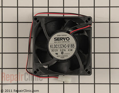

    By Fan motor do you mean the thing in the attached photo ? That is the same part he replaced once before. The one I've pictured here is the new one he didn't put in on his last visit.

    Ok, that fan in the photo is the evaporator fan in your freezer, thats the only fan in your freezer.
    Now on this model you have a custom cool fan, I believe thats in your refrigerator section about half-way down, do you see anything in your refrigerator section that says Custom Cool?
    Here's the fan for that:
    The manufacturer has replaced part number WR60X10227 with this item, part number WR17X13035.
    I've never changed this fan before, so I really don't know how to access it.

    A fan like that came along with the new damper. It was up in the plastic and styrofoam. It sits near the top back of the fridge. Our fridge didn't have one of those and when he pulled the new damper in this fan made a racket. He removed it since there wasn't one there to begin with.
    I guess my problems are with the evaporator fan again.

    Ok, then it has to be the evaporator fan thats making that noise, I'd first check to make sure the fan blade isn't rubbing on something before ordering a new one.
    Here's the evaporator(freezer) fan motor for your model you can order here if needed:
    Manufacturer's Number: WR60X10307
