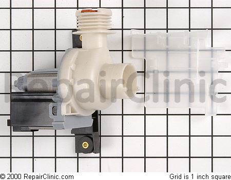

    Hi Matthew,
    Sounds like its not pumping the water out properly and that would cause a "no fast spin" issue.
    You may have a clog in your drain motor, or a impeller fin or two is broken off inside it.
    Remove the hoses and carefully look inside for clogs or broken impeller fins in the drain motor.
    Manufacturer part number WH23X10016 is RepairClinic item number 947781

    UPDATE:
    Removed the discharge pump. It was indeed blocked. The intake was completely jammed by a Purex 3-in-1 sheet. Never use these!:
    So I removed the pump, inspected the impellers (all ok), cleaned everything up, hooked it back together and ran a load for testing . . . no love.
    At the Fast Spin cycle I can hear the pump working, I can hear water draining.
    At one point the timer goes 'click' I can see the basket try to spin, then 'click' and it sloshes back down to bottom dead centre.
    Then 'click' I can see the basket try to spin, then 'click' and it sloshes back into place.
    Then 'click' it tries to spin, 'click' it sloshes back into place.
    It seems to try this three times, it looks like it can quite get over a certain hump, tries to spin hangs there . . . then gives up.
    Meanwhile the pump is still pumping.
    After a bit it starts sloshing around, back and forth. Then stops.
    No fast spin.
    Any other ideas?
    Matthew

    63,247
    Ok, if I understand correctly you want me to empty the tub of water and test without clothes.
    Yes, but from what you said the drain pump was running, but there shouldn't still be water in it if the drain pump is running, so that tells me you still have a clog in it, or in the drain hose itself, thats why it won't do a fast spin.

    Ok . . . solved!
    Removed the discharge pump again in order to examine the discharge hose from the drum. The pump intake was again completely jammed by another Purex 3-in-1 sheet!
    Removed the sheet, stuck my fingers up into the drum, seemed clear, reassembled. Ran a test cycle, all pumped out perfectly.
    Thank you for your help Jake!
    See you in another three years!
    Matthew
