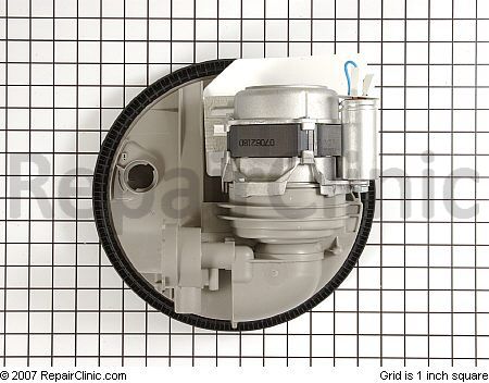

Changing the complete sump/motor assembly is much easier, but cost more money, would you rather do that?
Here's the sump/motor assembly for your model:
Manufacturer part number W10237170 is RepairClinic item number 1548392
W10237170

If it is significantly easier (meaning we could do it ourselves without problems), I think I might prefer to replace the whole assembly, if we can do it without pulling the dishwasher out. Our concern is that we've never done this before and don't want to make things worse.

Yes, you can do it without pulling your dishwasher out, but its much harder to do that way unless you've changed the sump/motor before.
As its more difficult to reach your hand below the tub to remove the drain motor, the 3 plastic sump mounting clips and the thermistor.
