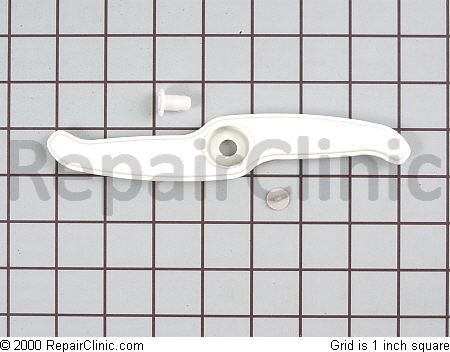

    One day I found the items in the attached photo laying in the bottom of my dishwasher - they are supposed to be attached to the top of the dishwasher above the glass rack. I had hoped that if I pushed them back in they would snap in somehow, but they just fall back out.
    Can anyone help me reattach this? Did I lose a screw or something? The KitchenAid manual is no help, there is no parts list in there.
    Attached Thumbnails Attached Thumbnails KitchenAid KUDM01TJ upper spray arm fell off-img_1324.jpg
    63,679
    Looks like your missing a smaller part that secures it to the top inner feed tube.
    To install it there should be a screw that holds the inner feed tube up towards the top, just remove that screw, then it should snap together in that inner feed tube.
    Here's the upper spray arm kit for your model you can order:
    Manufacturer part number 8193504 is RepairClinic item number 903947
