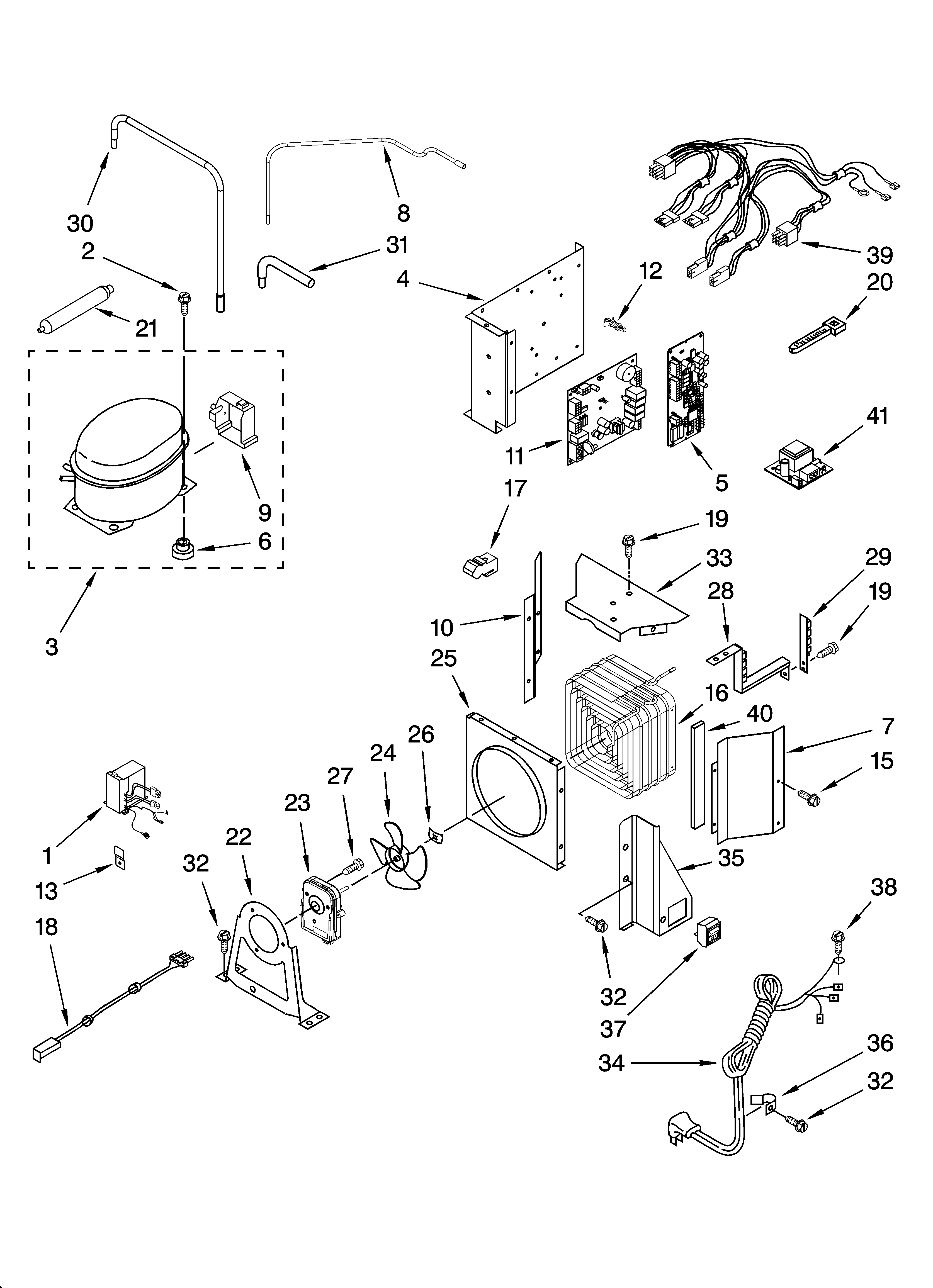

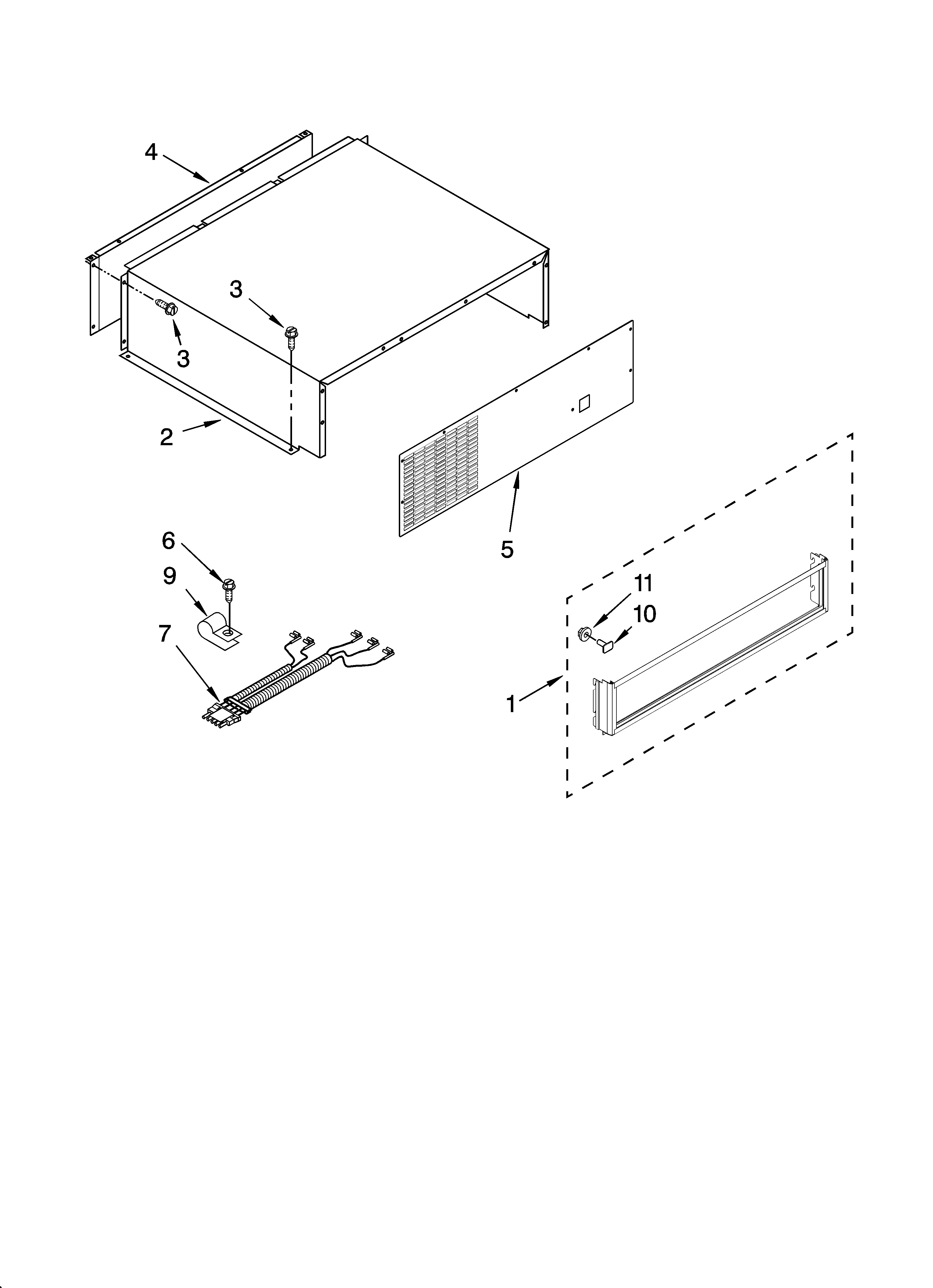

    Rick, how do I see if the condenser fan motor is working? The cycling is intermittent which is going to make it extremely difficult/expensive for technician to troubleshoot.

    Quote Originally Posted by Roslyn View Post
    Remove #1 and feel if any air is blowing through #5 or............
    Remove#5 and you'll be able to see all this:

    Rick-sorry it has taken me so long to get back to you. Went out of town. Yes I can feel air moving. To make matters worse, the cycling is all the time now and other loud sounds are happening periodically.
    We had a service tech come out this morning and he said it needs a new Main Electronic Control Board. He was here less than 3 minutes. Company is supposed to call back with a repair quote but I had to pay him $89.95 today. Do you know what the part number that would be and how easy it would be to install. We have installed many cards in desktop computers so I am not afraid to install the new one if the price is right. He also said that the card could fail before he could get the part and come back to install it. Obviously I want to fix this before that would happen. Thanks so much!!!
    going to make it extremely difficult/expensive for technician to troubleshoot....... He was here less than 3 minutes.........had to pay him $89.95
    Shoot! Oh well, I would have said, sounds like the main control board needs to be replaced. It's #11 in the parts breakdown and is fairly easy to replace. (Looks like they're currently out of stock.)

    Rick thanks for part number. What part number is control board that is labelled #5 on that same diagram? The repair shop called back and said they would order 2 controllers, the 1st one you mentioned and the second one she said was W2318054 but I can not find that part anywhere. Can you tell me what the correct part number is for that 2nd board. Do you really think I need to replace both boards or just the main one? Thanks so much!
