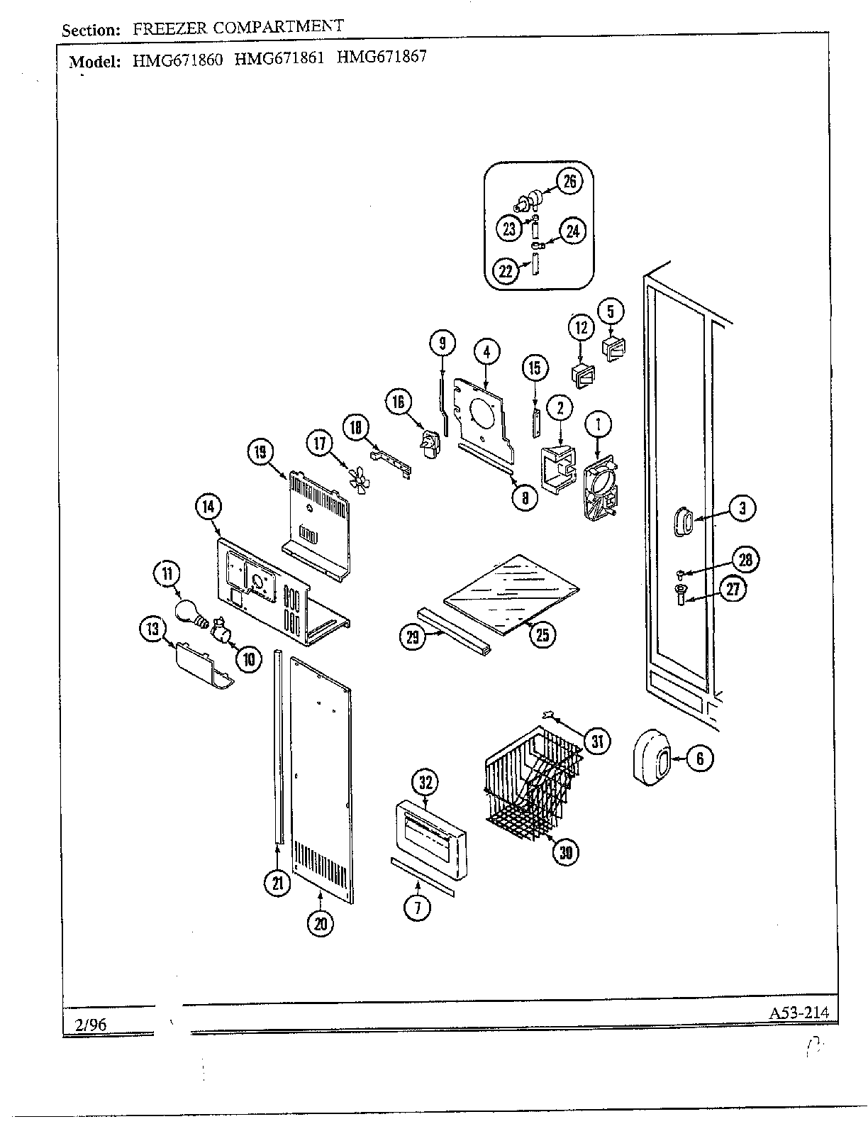

A couple of times now I have found a puddle on the floor in front of my side by side. It is about 5 inches in front of the fridge part. I do not see a line coming from the fridge or freezer. I looked at the fridge door & all is dry. I looked under the fridge & I see dirt & dust, but no wetness. Where can this puddle be coming from? I am not the orginal owner so I am not sure exactly when it was purchased. The fridge is cold & all in the freezer is frozen. Thanks for your help. Jina

Your defrost drain hole/line may be clogged, thus putting water on your floor instead of in the defrost drain pan thats located under your refrigerator.
Turn your refrigerator/freezer temp control to OFF then Take the food out of your freezer, then take the shelves out, then take off your lower back panel inside your freezer, its #20 here:
http://c.searspartsdirect.com/lis_pn...1575-00013.png
Then see if your drain trough that sits in the very bottom back under your evaporator coils in the freezer is clogged with ice. If so, get a hair dryer and hot water to melt it.

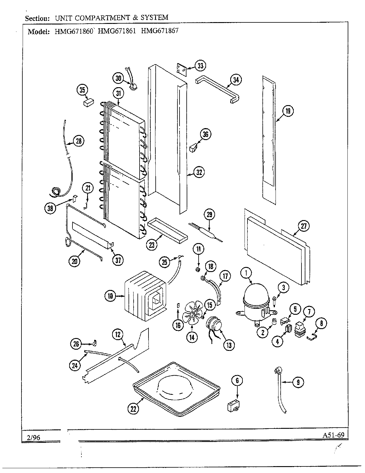

Jake-We were not able to get that snake, however we did everything else. There was a huge ice block that I got rid of. Problem: The hole inside the drip tray inside the freezer does not line up exactly with the tube-as a result when we poured hot water into the drip tray, the water went thru the hole in the drip tray, but missed the tube & instead came out the front of the freezer. I hope this makes sense. Can you help us with this? My frozen food is thawing right this very moment. Thanks/Jina

Ok, try to re-align the drain trough with the hole, best you can.
The metal drain trough#23 should be connected to the back metal shield#32 of your evaporator coils#31 here:
http://c.searspartsdirect.com/lis_pn...1575-00015.png
There should be a couple screws that you can loosen on that metal shield and re-align it.

Jake-I unscrewed those 2 screws, however, the tray is also riveted to the back panel. I cant move it. What now? Thanks/Jina

Unfortunately, not much, unless you break the rivets.
Just line it up the best you can and see what happens.

Hi-I packed in plumbers putty under the tray & I used floral wire to snake
the tube. It went in about 30 inches & pushed out some junk. This morning there was no water on the floor, but FINALLY there was some in the tray under the fridge. Im not sure if this is a temporary fix, but it worked! Thanks you VERY much for your help. Jina

Good job Jina, that should fix it permanently.
