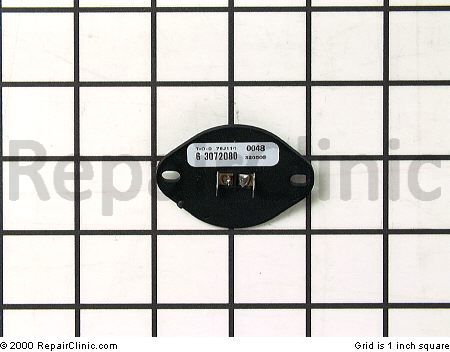

Ok, basically all dryers have either a thermistor or cycling thermostat to control the temperature in dryers.
Your model dyer will have one of these below.
A thermistor looks like this:
Manufacturer part number 307208 is RepairClinic item number 484272
307208
A cycling thermostat looks like this:
Manufacturer part number 33002567 is RepairClinic item number 791153
33002567
Its mounted on the front of your blower wheel housing #8 here:
Unplug your dryer first!
To test the thermistor you use a ohm meter and go by this chart:
Here's the thermistor chart, it works on ambient temperature:
To test the cycling thermostat you just do a continuity check on it with an ohm meter, normal would read 0 ohms.

ok,i checked the cycing thermo. and theres another one(looks same) down on the pipe where the thermister is. they both read 0 on the meter. now the thermistor read half way between 1 and 2 and it never really seemed to change even going from cold runnung water or hot water?

rechecked it by holding a lighter away from it and checked it with infrared thermometer and it read 179 and the meter said less than 1 and then running the tip under cold water the scale went up almost to 8000+ if i'm reading the meter right?
