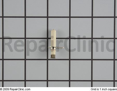

Posts: 30,221
You have 2 separate problems.
Ok, so you will need to order and replace the oven igniter to make the oven work again.
And likely the 2 left surface burner igniter's.
Manufacturer part number 74011755 is RepairClinic item number 1205014
74011755

Thanks Jake, but I have one more question. When I turn the surface burners on, the left ones spark, are they just maybe not sparking strong enough? Should I try to light the burner with a match to make sure its not a gas or pressure issue?
  #8
Old October 7th, 2009, 09:21 AM
Posts: 30,221
Yes, use a match or cigarette lighter to lite it.
When the spark igniter goes bad, it will click but either be weak and not ignite or no spark at all.
  #9

Posts: 30,221
No, you can't lite the oven with a match, its controlled by the oven igniter glow bar.
To change the top igniter's just take off #2 #3 then #22 #23 then you can remove the igniter from #15 here:
http://c.searspartsdirect.com/lis_pn...3018-00004.png
