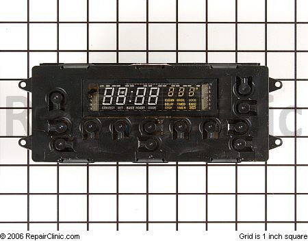

Jennair Double oven bake element would not heat. I tested the element and it is good...Used ohmeter. I opened up the contol panel and swapped the broil power lead with the bake power lead and turned on the bake switch. The bake element came on and worked. So I have ordered part 71002215 the clock control panel as this appears to be the cause.
The bottom oven was working ok until I opened the control panel. Now the bottom oven does heat but it is very slow to come to temperature. I set it to 400 and it feels very hot in about 15 to 20 mins which is pretty slow. THe green indicator stays on. If I rotate the temp to a lower setting the green light will go out to indicate the desired temp is met but it is way less than what I wanted. Curious as to what I need to check to fix this oven. It has worked flawlessly until the initial no heat bake element in the upper oven..

Yes, sounds like to me its the clock/oven control board thats bad.
Here's the 71002215, its more costly(its new, not rebuilt), but you can get it faster here:
Manufacturer part number 71002215 is RepairClinic item number 695518

Thanks Jake...Just replace the clock/controller and it fixed the upper bake problem...Still seems a bit slow to heat the upper oven but it appears to be working...When I re-opened the clock area, I did find a black wire labelled Therm2 that had become disconnected...Using the wiring diagram, I cannot find where it went too. The bottom oven is still working oddly...I am wondering if this is the problem...

Sorry to bother...But I just found where the black wire goes...It must have came off the lower oven switch when I initially pulled the clock/control out...I was able to find it on the wiring diagram...Connected it and now the lower oven works...
The new clock/controller also fixed the initial problem of the upper oven bake not working...
However, the upper oven appears to be slow to heat to 350...It took almost 10 minutes...It may be normal as I do not use the oven much...
Let me know how long it should take to heat...thanks..

Sounds like you got it.
Yes, 10-15 minutes to heat to 350 is normal on all ovens.
