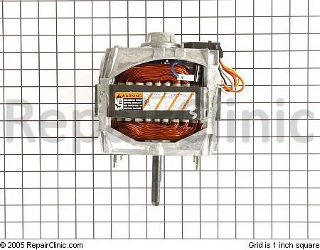

    63,293
    Thanks jackofalltrades for helping out here, and the other posts, Its been crazy busy here since Thanksgiving.
    Nelson, Here's the motor for your model:
    Manufacturer part number 12002353 is RepairClinic item number 1066793
    12002353

    Default Resolved - Finally!
    Thank you for your help!
    I finally got to a point where I could pull out the dryer out the room, move the washer and check the motor and switch.
    The orange wire had fallen off of the switch!
    Proper application of some needle nose pliers and some abrasive cloth will hopefully prevent this problem from happening again.
    Thanks again for your help to diagnose the problem!
