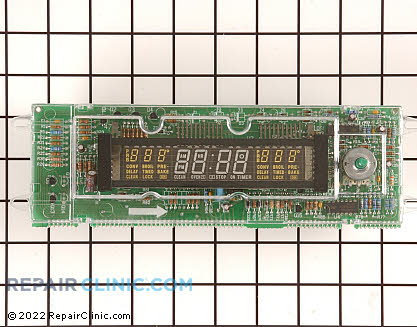

    Top oven just stopped working - no settings work. Neither element heats up. Bottom oven works fine. No error codes or problems with clock/display.

    sorry, didn't really finish my question. Was wondering if anyone knew if this was more likely to be a relay board or the circuit board/timer unit??
    63,679
    On this model you don't have a separate relay board, its all integrated in the clock control board.
    Manufacturer part number Y04100264 is RepairClinic item number 1242523
    pgmazza is offline Member
    Dec 2010
    illinois
    well, I guess that makes it easier. When I looked up the model number on the web site it showed me three boards, two relay boards and the clock board.
    I'm going to order the clock board and hopefully that will do it.
    63,679
    Yes, I didn't see any relay board's for this model.
    This is a rather old model, so not sure if the parts diagram matches what your model is exactly.
