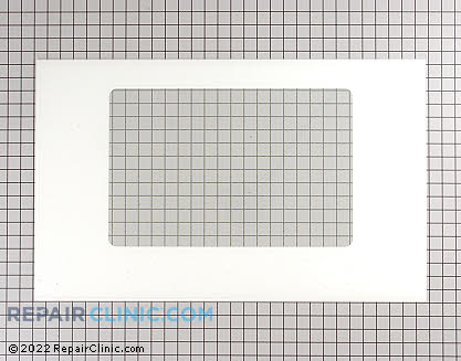

    Hello, our oven glass door was shattered and I would like to know if I can replace it myself. Unfortunately, I'm not sure if I have the correct Model number of the oven. The only number I can find is 8114P527-60 that was listed about the customer service number located on the upper right corner inside the door. When I went to Google the number, the result came back stating it's a Jenn-Air but our oven say Maytag on the front. Are they the same? I can't seem to find where I can order a replacement glass and was also wondering how easy is it to install the oven glass door.
    I am hoping to be able to replace the glass door without having to but a new oven. Any help will be much appreciated. Thank you.

    Unfortunately, thats not the model#.
    Help Me Find My Model Number - RepairClinic.com
    Yes, its fairly easy to replace, once you post your model# I will link you to the glass for yours.

    Hello Jake,
    I wasn't able to find the model number because the sticker that has the model number is worn out and all the numbers are gone. I was able to find three model number that might match my current oven. Can you tell me if they might all have the same glass door type?
    MEW5530AAW
    MEW5530ACW
    MEW5530BCW
    63,257
    Ok, those first 2 model#'s you listed use this one:
    Manufacturer part number 74006636 is RepairClinic item number 902392
    The last model# you listed uses this one:
    Manufacturer part number 74005570 is RepairClinic item number 894968
