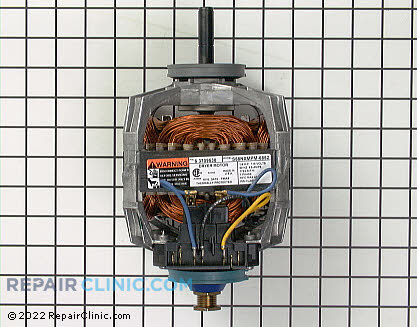

    I have a Maytag MDE9206AYW dryer that stopped working last week - low hum and tumbler not turning. After taking the front panel off and doing some basic troubleshooting I didn't find anything obvious. I started it up no problem without the tumbler in so I re-installed the tumbler and belt and it started up fine. After about a half hour I noticed that the timer control had not advanced when set to Auto cycle. However, it does operate properly when using the timed dry cycle setting.
    I assume this must be related to the cycling thermostat or timer motor?
    Yesterday, the dryer would not start again with same symptoms - low hum from the motor and tumbler not engaging. From other posts this sounds like a classic case of a motor on its way out. I did ohm out the windings and the start winding is 2ohms instead of the specified 3 ohms so I suppose this could indicate a winding going bad. All other tests looked good.
    Before I lay down the cash for parts does this sound like I'm on the right track?
    Also, does the switch come with the motor or should I replace that at the same time

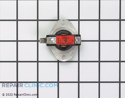

    Ok, for the timer not moving in auto-dry, First clean the sensor bars that are located in the dryer with rubbing alcohol, a coating can build-up on them overtime and cause this issue.
    Yes, you would need a new motor. I will need the serial# of your dryer as they make 2 different motors for this model.

    Ok, looks like your model doesn't have the 2 metal sensor bars.
    In that case, you would need the cycling thermostat then to fix the auto-dry issue(the cycling thermostat is located on the front of your blower wheel housing):
    Manufacturer part number 307249 is RepairClinic item number 484290
    Here is the motor for your model you can order:
    Manufacturer part number 33002478 is RepairClinic item number 776953
    Here's how to access your motor:
    Maytag dryers, how to take apart my Maytag dryer, L shaped door
    Here's the repair manual for your model:
    www.applianceblog.com/manuals/16023110.pdf
    The motor removal and replacement is on Page 7-4 you can print out.
