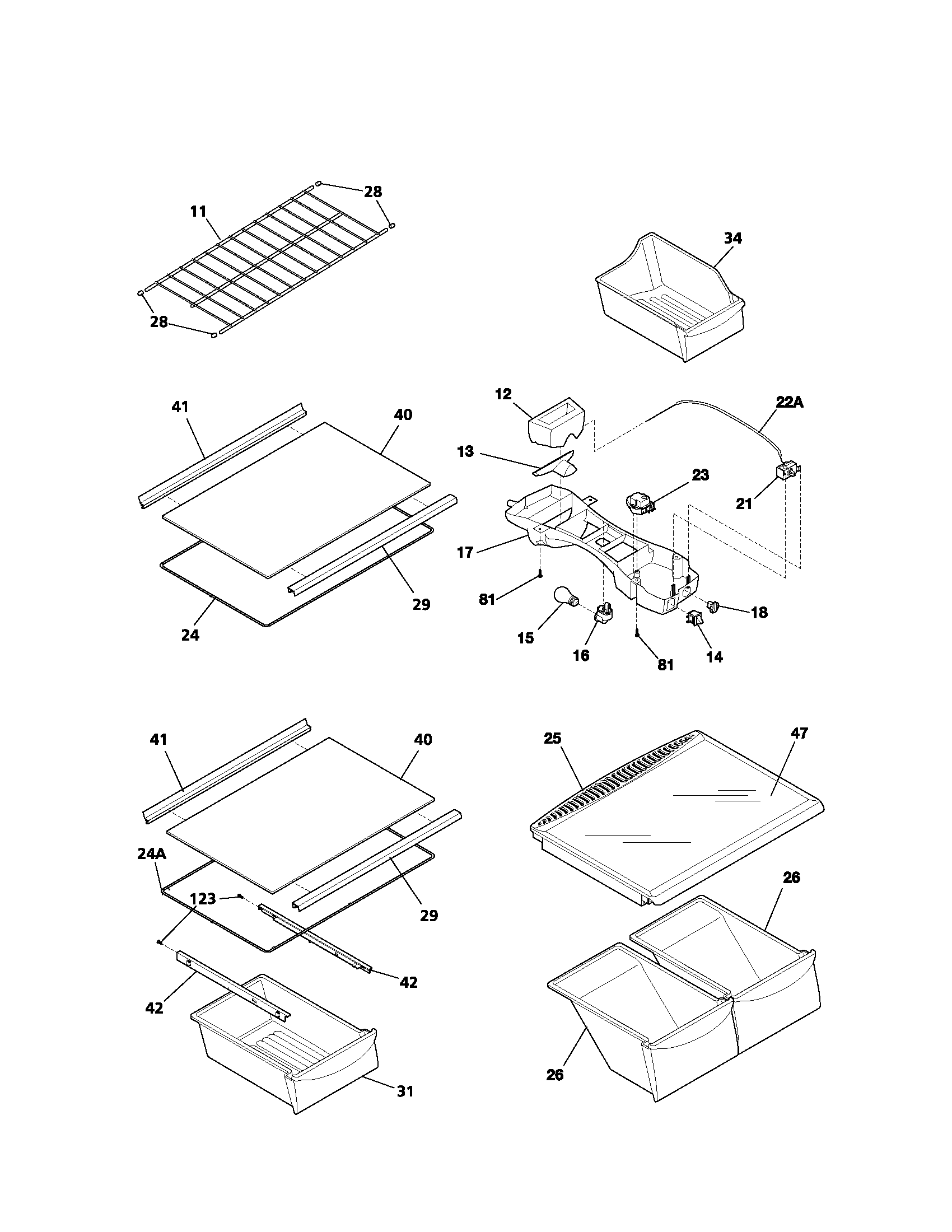

    OK, unplug the machine. Unplug the connector for the evaporator fan motor and remove the cover. Make sure there is no ice in the air chute. If it's clear, replace the cold control:
    Temperature Control Thermostat 5304421256 Order now for same day shipping. 365 day return policy. RepairClinic.com
    Kenmore fridge/ top freezer: Freezer cold, fridge not.-temperature-control-thermostat-5304421256-00839339.jpg

    I've decided to order and replace the part. Could you please let me know in which area of the fridge this part is located? Is it in the freezer, fridge or lower back?
    rickgburton's Avatar
    rickgburton is online now Appliance Tech - Moderator
    Jul 2006
    Murray, Utah, United States
    13,678
    #21 temperature control
