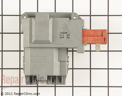

    The washer stops at the final spin cycle. The error code is E47 - Board thinks the door PTC circuit is open in spin.
    The diagnosis manual suggests either a defective door lock assembly, or a defective control board. I performed the test of measuring the resistance of the PTC (it measured 1525 Ohms) which indicates the door lock assembly is ok. I ordered a new control board (P/N 134732004) and installed it, but the problem persists and the E47 error code returned after I cleared it.
    Any advice on what else to check?

    To follow up, I replaced the door lock assembly and that fixed the problem.

    Thanks scott for letting us know what fixed it.
    Here's the door lock assembly for your model, in case others need to order it as well:
    The manufacturer has replaced part number 131763245 with this item, part number 131763202

    I followed the directions in this forum and managed to fix my washer. I measure the resistance of the PTC and it was 2250 ohms. Not shorted and not open, but it was higher than the 1500 or so specified. I bought a new door switch and that one measured 1250 ohms. Anyway, I removed the top cover and replaced the switch in about 5 min. The washer runs fine now.

    Default Same for me, 1500 Ohms but replacing door latch fixed it
    Same fix for me.
    Kenmore 417-44252500 (made by Frigidaire apparently)
    During spin cycle, drain pump was working, but there was no high speed spin.
    Ran diagnostics. Everything worked including fast spin. (Fast spin only worked in diagnostics.)
    Checked last error code, got E47 which is "Board thinks the door PTC circuit is open during spin, refer to Test (9)."
    Performed Test (9), which consists of unplugging unit, removing the door latch switch and measuring the resistance of the PTC.
    It was ~1500 Ohms, thus very clearly indicating a defective control board, according to the Washer Tech Data Sheet (an open or shorted circuit would have indicated the door latch switch was defective).
    HOWEVER, after some Googling, I haven't found anyone online for whom replacing the control board fixed the problem! I found that with these symptoms (high spin working only in diagnostic mode) it's "almost always" the door latch but supposedly still COULD be the (motor) control board (part # 134409900). Yet I found not a single actual report of it's having been the control board.
    So with the Tech Data Sheet strongly saying one thing but no evidence to be found online in support, I remained hesitant until I found this post (thanks for posting!) where even after passing the 1500 Ohm test, the fix still involved replacing the door lock assembly.
    I got a door latch switch (part # 131763202) that was in stock nearby, and it worked.

    To remove the door latch, you don't even have to move the washer. Use a pair of needle-nose plyers to remove the spring/wire band that holds the door gasket in place, pull a bit of the gasket out of the way near the latch, remove the two screws (save them, they're not included with the replacement part), and unplug the three wiring connectors.
