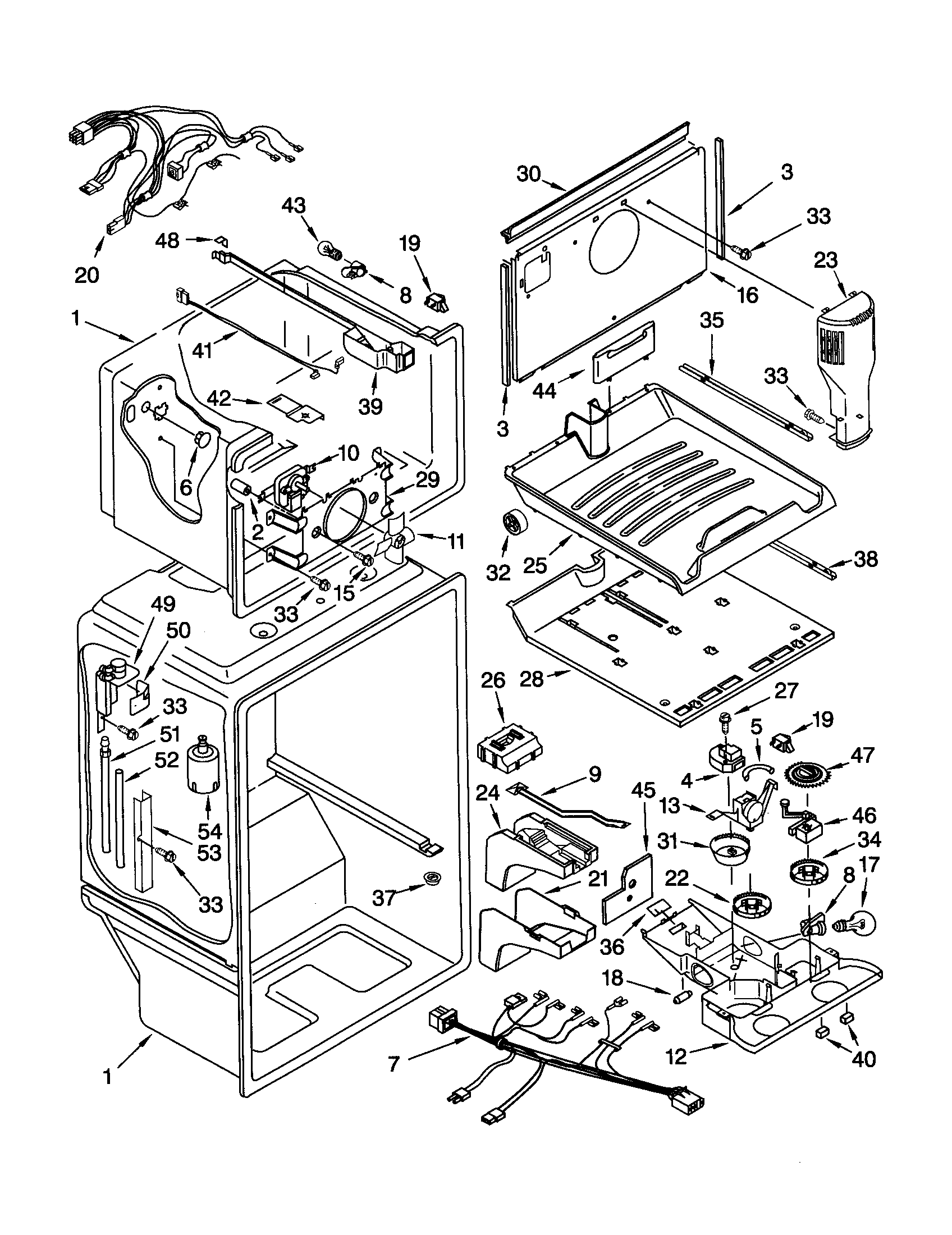

In regard to the ADC, in my repair to this point, I never saw/found the ADC. Where is it ?
David

Your ADC is located in the console control panel#12 that mounts on your refrigerator section ceiling, its #4 here:
http://c.searspartsdirect.com/lis_pn...3003-00002.png
If you ever need to replace it, you just remove the console control panel#12 and the whole assembly drops down abit, then you can access the ADC and the cold control thermostat#13.
The console control panel has 2 screws on each side of it that mounts up into the ceiling.
