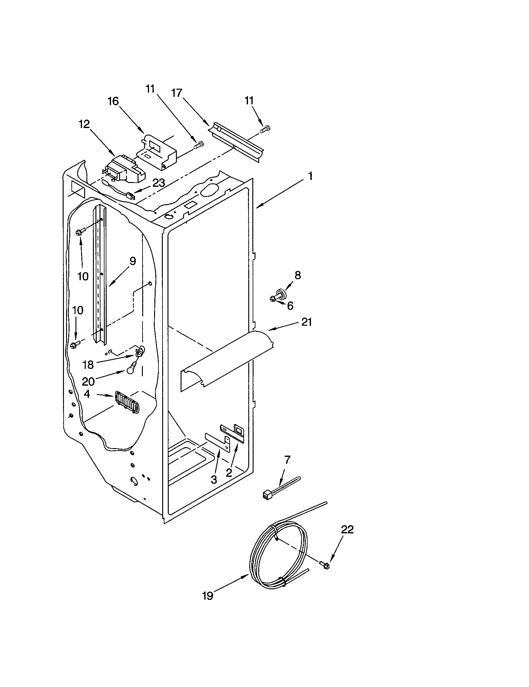

Here's a service bulletin I found for this issue:
http://adcxns1.whirlpool.com/Service...LE/8178611.pdf
Check your Return Air Vent Grille in Fig. 1 first for ice clogs, it just unsnaps off, and look at Fig. 7 to see if yours has that gap in it.
Here's the diffuser for your model you can order:
Manufacturer's Number: 2216112
2216112
Your diffuser is #12 here:
http://c.searspartsdirect.com/lis_png/PLDM/P0203369-00002.png
If you plan on doing it yourself:
Just remove that side panel #17 then remove#16
Then you have to push-in on the 4 clips from the freezer side to remove it.
You may have to remove the ice maker and the air tunnel to get to it.

Yup, that vent was iced up at one point, I defrosted it though. Still the same issue with the top.
Do you think there is another problem with the fact that it ices up in the first place ?
Old June 24th, 2009, 05:42 PM
Posts: 30,227
Well, other than the service bulletin I posted above, I'm not sure whats causing to freeze.
If when you open the freezer door and put your hand in front of your top vent diffuser inside your refrigerator section and you feel plenty of cold air coming out and you close the freezer door and the air flow from the diffuser is hardly coming out, that still means you have ice blockage in that return vent tunnel where it goes to the bottom of your freezer, I'd flush all that out with hot water down the return vent tunnel and use a hair dryer as well, to make sure all the ice is out.
