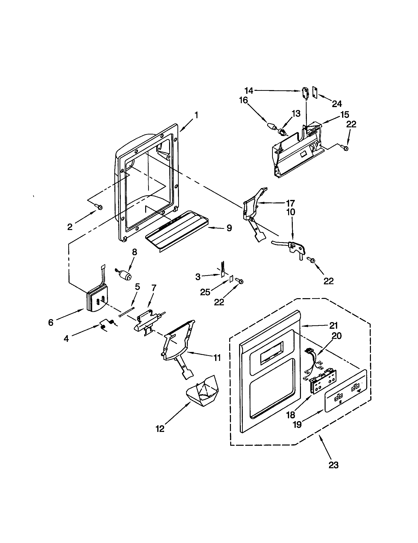

Hello,
I have Kenmore s/s refrigerator model #10652572201.
somehow, ice dispenser is not working at all, although it still makes ice and dispenses water. I couldn't find anything stuck in the basket.
What can be wrong? What part do I need to repair?
Thanks for any advice!

Sounds like the plastic pins thats on the water/ice dispenser support have broken.
You would need to unsnap(use a flathead screwdriver in the 2 little slots underneath the bottom frame piece to unsnap it) your front dispenser frame#23 here:
http://c.searspartsdirect.com/lis_pn...6019-00007.png
Then look at your support bracket#15 to see if the little plastic pins are broken that hold your ice and water dispenser switches in place#14.
Here is the one for your model, in case you need to order it:
Manufacturer part number 2180226 is RepairClinic item number 449582
2180226

Yes, I found the little pin on ice dispenser side was broken.
I just ordered the part. Is it simple to replace the part?
thanks again!

Excellent, yes its easy to replace, just remove the switches, you will see they just clip in place, and snap them in the new one.
