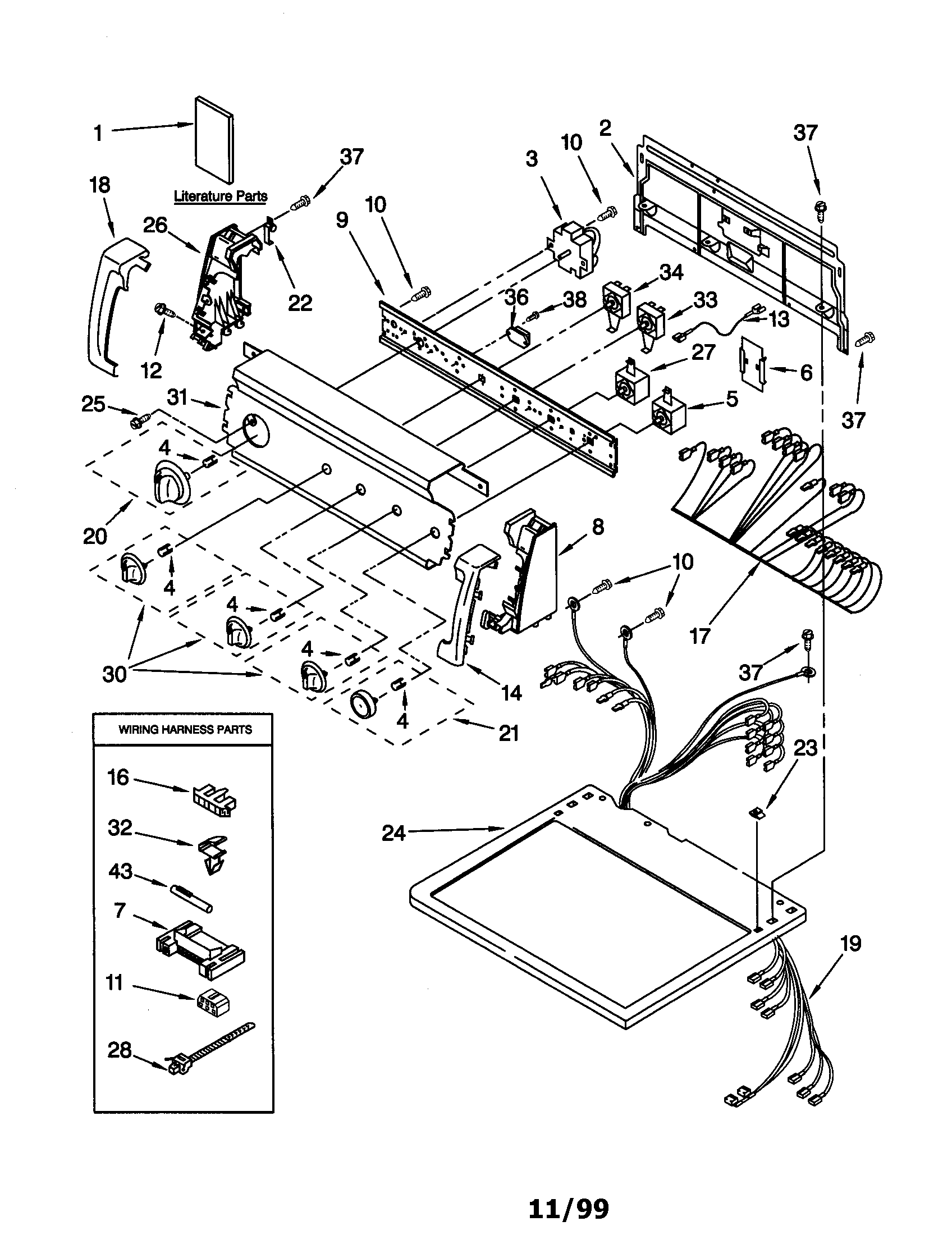

#36 here is your motor/heat relay, some models have 2 of these, check yours to see:
http://c.searspartsdirect.com/lis_pn...0081-00001.png
You can swap the heater & motor relay to see if it stays running. They are the identical same part. Unplug your dryer first before swapping them.
Manufacturer part number 3405281 is RepairClinic item number 528722

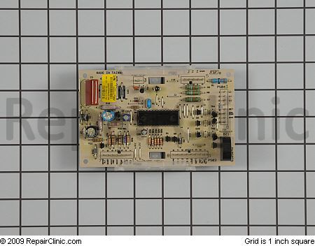

Then its possibly your control board, look for burned spots on it. There is no way to test it other than that.
Manufacturer part number W10116564 is RepairClinic item number 1480790

I just removed the control board as you suggested and am looking for burn spots. Here is what I found.
I don't see any "heavy" burn marks anywhere, however, looking at the control board the same direction it sits in the dryer I see this.
In the lower right hand corner of the unit right around station D2, D5 and D9 the board is dark brown as if it got hotter than normal. Nothing looks to be burned or melted though.
Does this sound like the culprit??? Let me know what you think now and if needed I will order the new board from you.
Thanks, Darren.
  #6
Old September 26th, 2009, 07:52 AM
Posts: 30,223
Yes Darren, A new board should fix it.

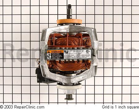

It may be the motor itself thats overheating and going bad.
Here's how to change the motor and shows how to take off the blower wheel:
part number 3395654 with this item part number 279787 A tip for changing a Whirlpool dryer motor
Here's the motor for your model you can order:
Manufacturer part number 279787 is RepairClinic item number 158
279787
Lots of times the blower wheel will be stuck on the motor shaft and you have to break it off as described here:
