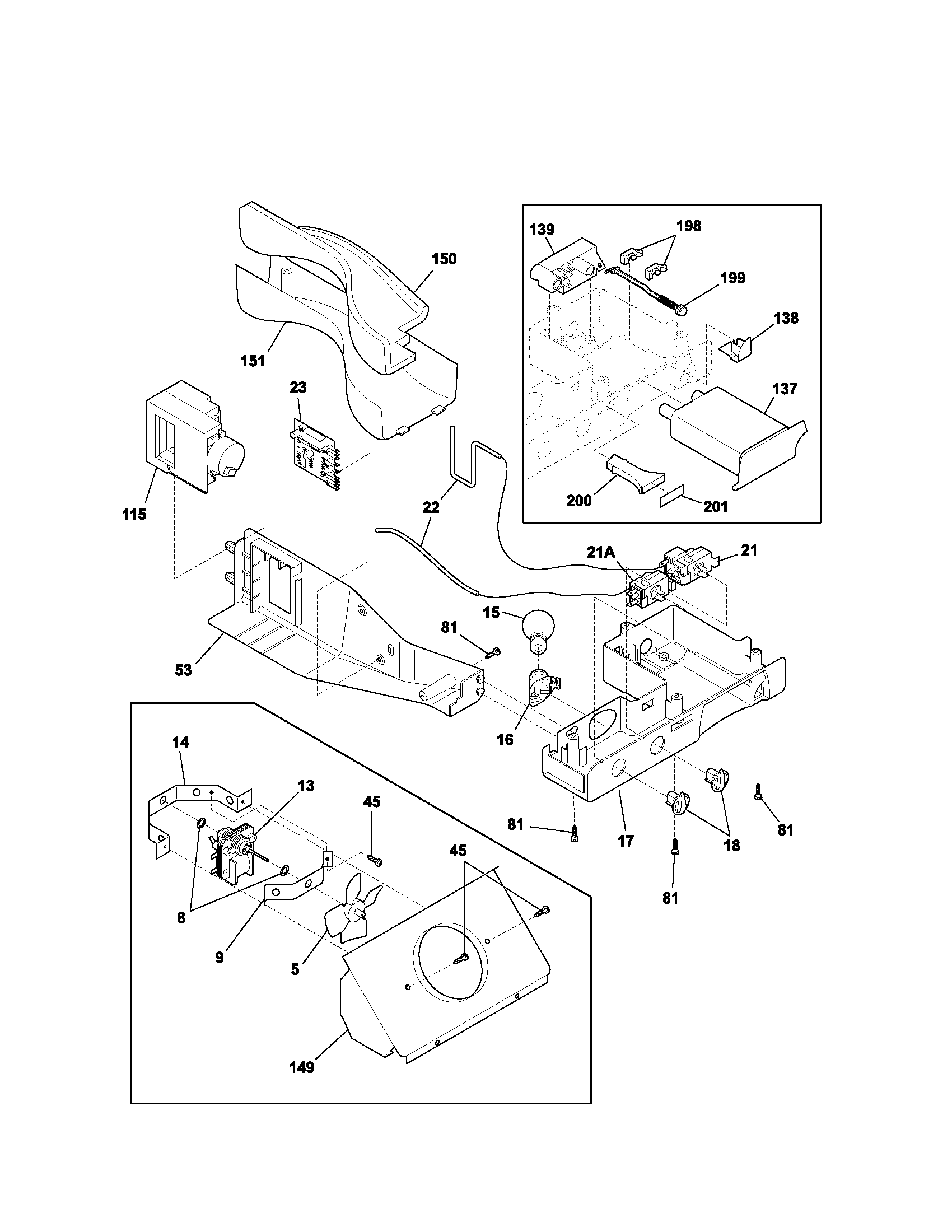

Ok Scott, on this model you have an adaptive defrost control board instead of a mechanical timer. Its #23 here:
http://c.searspartsdirect.com/lis_pn...8518-00005.png
Yes, its possible that it could be a bad adaptive defrost control board not coming out of defrost.
Try this:
This is from Jeff's site, your Kenmore 253 model is a Frigidaire:
Frigidaire has also jumped into the market with an adaptive defrost board. The fresh food section light switch and light bulb must work. To initiate a defrost cycle, open the door and push the light switch in and out 5 times within 6 seconds. The compressor and fans should shut off and the defrost heater should come on. Open the door and push the light switch in and out 5 times within 6 seconds to remove the refrigerator from the defrost mode and back into a cooling mode.
