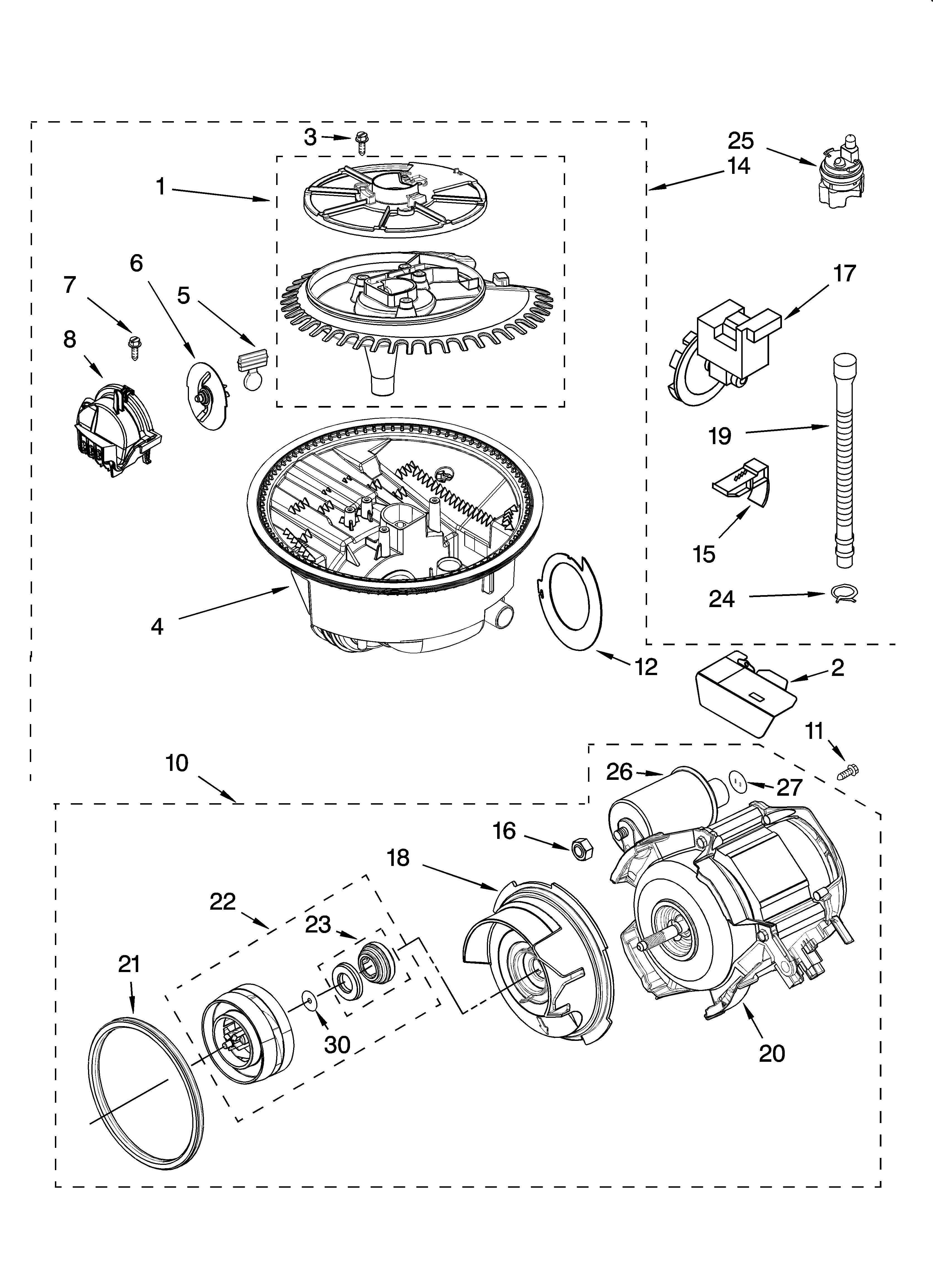

    Model Number: 665.76965K601
    Model number Kenmore Elite 665.76965K601
    Age 3 years
    All the cups and small plates in the top rack of my Kenmore are not getting washed at all. The only thing they get in the condensation from the heat of the water below.
    The top spray arm is not spinning - I have checked this by leaving it in one position, turning it on (on any setting) and when I open it mid stream, the arm is in the same position it started in. Water is gingerly coming out.
    In the past when the top spray arm hasn't worked, it's been because something is blocking it (A big plate in the bottom tray). This is not the case this time, and when I spin the top spray arm, it spins fine, although not for a long duration of time.
    My guess is that the two holes that feed the top spray are are both open (perhaps due to age? I don't know??) and perhaps there is not enough 'volume' that causes the top spray arm to turn??

    The one hole in the photo is open because thats where the middle spray arm manifold goes into when you push your upper back inside the dishwasher.
    It more likely an issue with either the chopper screen blade broken or the motor.
    Here's the repair manual for your model:
    http://www.applianceblog.com/manuals/pointvoy8178022.pdf
    Page 17 Read 1-4 where it says this:
    SERVICING COMPONENTS INSIDE THE WASH TUB
    Removing the Inner Feed Tube and
    Lower Spray Arm
    Then on Page 21 it starts to get into detail of how to access the rest where it says this:
    Accessing Components of the Sump Assembly
    It shows how to get access to the chopper screen.
    Here's the wash motor assembly:
    Manufacturer's Number: 8534942
    Here's the sump/wash motor assembly for your model you can order:
    Manufacturer's Number: W10237169

    Jake, I called a local repairman and he said for a 3 year old dishwasher, it sounds like the filter is clogged not allowing water to make it up to the top shelf. Is this possible, and if so, where is the filter on this unit? I don't see anything about a filter written in the repair manual?? Cheers!
    55,588
    59
    Thanked 3,151 Times in 3,129 Posts
    No, you just have the accumulator#1 here:
    http://c.searspartsdirect.com/lis_pn...2060-00008.png
    But I never see that clog up.

    Have you checked your water inlet valve? I had a similar problem. The dishes on the top wouldn't get clean and it seemed as though the top rack wasn't spinning.
    You have to go underneath and take apart the inlet valve. Mine was full of sediments from water and from the pipes. It's a little tricky because it was a small space, but the difference was amazing afterwards!

    That's exactly what it was...once I took apart the inlet valve that was clogged with sediments from our dishes including a chicken wing bone, now everything works great.

    Wait, It was the inlet water valve? That supplies water into your dishwasher? How in the heck could a chicken bone get in there??? That water supply line comes from your city water department, if they have chicken bones in the water supply line, thats not good.
    Or did you find the chicken bone in the chopper screen blade area, they would be the most likely place to find one.
    Well, at any rate, glad that fixed it.
    ApplianceBlog Classifieds
    bbtfastback is offline Premium Member
    Feb 2010
    Canada
    7
    0
    Yep - apologies...it was in the chopper screen blade area. THAT was definitely the problem...
