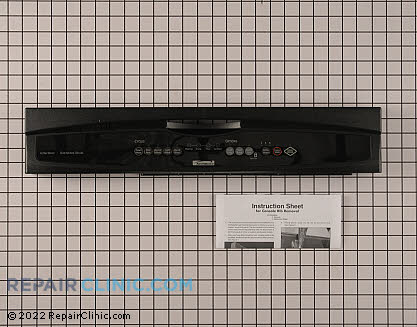

    I found it.
    Here's the black control panel for your model you can order:
    http://www.repairclinic.com/PartDeta...558202/1201340

  8. #18
    63,247
    You put 1 too many 6's in the front of your model#.
    Should be 665.17024400.
    I found it.
    What color is yours?
    Here's the black control panel for your model:
    Manufacturer's Number: 8558942
    Here's the white one:
    Manufacturer's Number: 8558943

    Another blinking light problem "Heated Dry" light flashing, washer will not work. have reset power breaker still nothing, pressing "Start/Resume" button just causes the "Normal Wash" light to flash with the "Heated Dry" and pressing "Cancel" will cause the "Cancel" light to flash also. Turning the breaker off/on just resets washer to flashing "Heated Dry". Mod 665.13832K601 Any help would be appreciated wife is already looking online for new machine...is she right?
    Doug.
  10. #20
    63,247
    Yes Doug, on yours it would be a bad control panel as well.
    Here's the control panel for your model, just chose your color.
    Black
    Touchpad and Control Panel 8558205 Order now for same day shipping. 365 day return policy. RepairClinic.com
    White:
    Panel-cntl 8558206 Order now for same day shipping. 365 day return policy. RepairClinic.com
