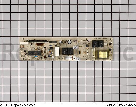

    This is a great forum! I have a 6 year old Kenmore. It holds in sensing mode and then attempts to start while the Washing,Sensing,Drying,Sanitized and lean flash with the 6 hour delay light. Got alot going on, huh?
    What is the typical life of these machines? Is it worth repairing?
    Thanks for the advice!
    Tray
    Here's a pic of my panel...
    Attached Thumbnails Attached Thumbnails Sensing / All lights flashing. Control panel issue?-kenmore.jpg
    63,657
    90% of the time its a bad control board when this happens.
    Now the $64,000 question, is it worth putting this much money into it? The answer is if its getting close to 8-10 years old, NO.
    Its about $173:
    Manufacturer part number 154445802 is RepairClinic item number 949261
