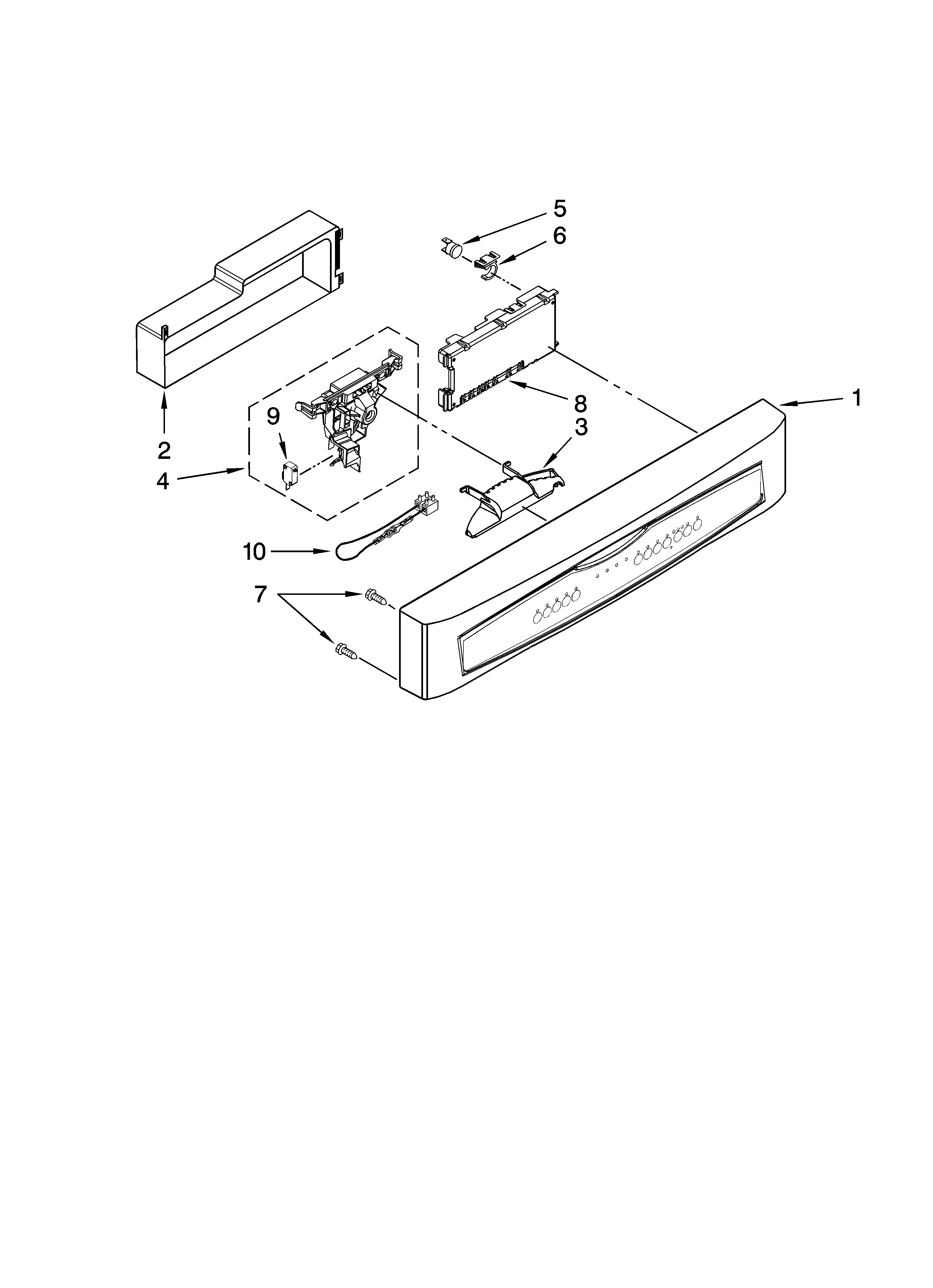

    Model Number: 665.13889K800
    I have a Kenmore Quiet Guard Ultra (665.13889K800) that has worked well for the last 14 months. Two days ago it failed to drain and now gives no indication at all of power. I have confirmed that the breaker is not thrown, and I have confirmed there is power at the outlet (120 V). I have tried reset button sequences I found on the internet, but that did not help. I would check the thermal fuse if I knew where it was and how to get to it. Does anyone know where I can find this fuse? Is there something else I can check?
    63,681
    You just remove the #7 console screws and the thermal fuse is #5 here:
    http://c.searspartsdirect.com/lis_pn...6012-00002.png
    Take the wires off the thermal fuse and ohm it for continuity. Turn the breaker off to your dishwasher first.
    Here's the thermal fuse for your model you can order here if its bad:
    Manufacturer part number 661663 is RepairClinic item number 1176509
    661663
