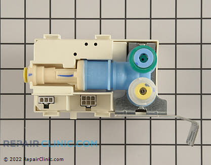

    My refrigerator started making a very loud and rattling type of noise and we weren't sure where it was coming from. I removed the water filter from the base and it stopped immediately.
    I thought maybe the filter might just need replacing, so I got a new one and upon installing it, it immediately starting the loud rattling noise again.
    The sound is almost like a jack hammer, when the filter is in place the sound is there, when I remove the filter, no sound at all and water runs fine.
    Any clues what would be going wrong with my refrigerator now?

    Its your filter housing valves that are causing it, seen this happen before.
    You will need a new filter housing.
    Here's the filter housing for your model, you can order it here:
    Manufacturer's Number: W10121138 is RepairClinic Item #1480816

    63,229
    So it wasn't the filter housing?
    Thats very strange, because you said with the filter removed it wasn't making that noise.
    Was it this:
    Manufacturer part number W10159839 is RepairClinic item number 1389142
    ChrisMc73 is offline Member
    Feb 2011
    Oklahoma City, OK
    I wasn't there to see what he pulled out, all I have is that info I typed from the invoice.
    Could this "Water Inlet Valve" be the same as the "H/D Electronic Control W/T Valve and Hardware Assembly" he put on the invoice?
    I'm just trusting he replaced the right part, as its working now and not making a noise.
    It didn't appear that he replaced the housing either. So this must be the part he replaced?
    63,229
    Yes, thats what I'm thinking, because thats the only valve for the water flow that costs that much.
    So I guess I was wrong, but you have this new type of water inlet valve called a "smart valve" that I haven't run into as of yet on any of my service calls.
    Thanks for the update, glad its working good again.
