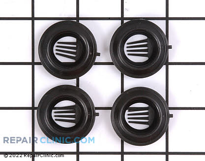

    Is this what your seeing? These are just the filters, they should come out with the inner tub:
    Manufacturer part number 285868 is RepairClinic item number 897727
