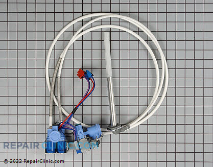

    It could be the water valve. Try taking the water line that goes to the dispenser, out of the water valve. Then actuate the dispenser and see what kind of water pressure comes out of the valve. If it's still little to none, shut the water supply off and see if the screen has a blockage where it connects to the valve, if thats fine, then order the valve.
    Here is the valve for your machine:
    Valve or Float Component 5221JB1004N Order now for same day shipping. 365 day return policy. RepairClinic.com

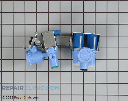

    63,217
    Ok, does this look like it:
    Water Inlet Valve 5221JB2006K Order now for same day shipping. 365 day return policy. RepairClinic.com
    Thats all the water inlet valves I show for this model.
