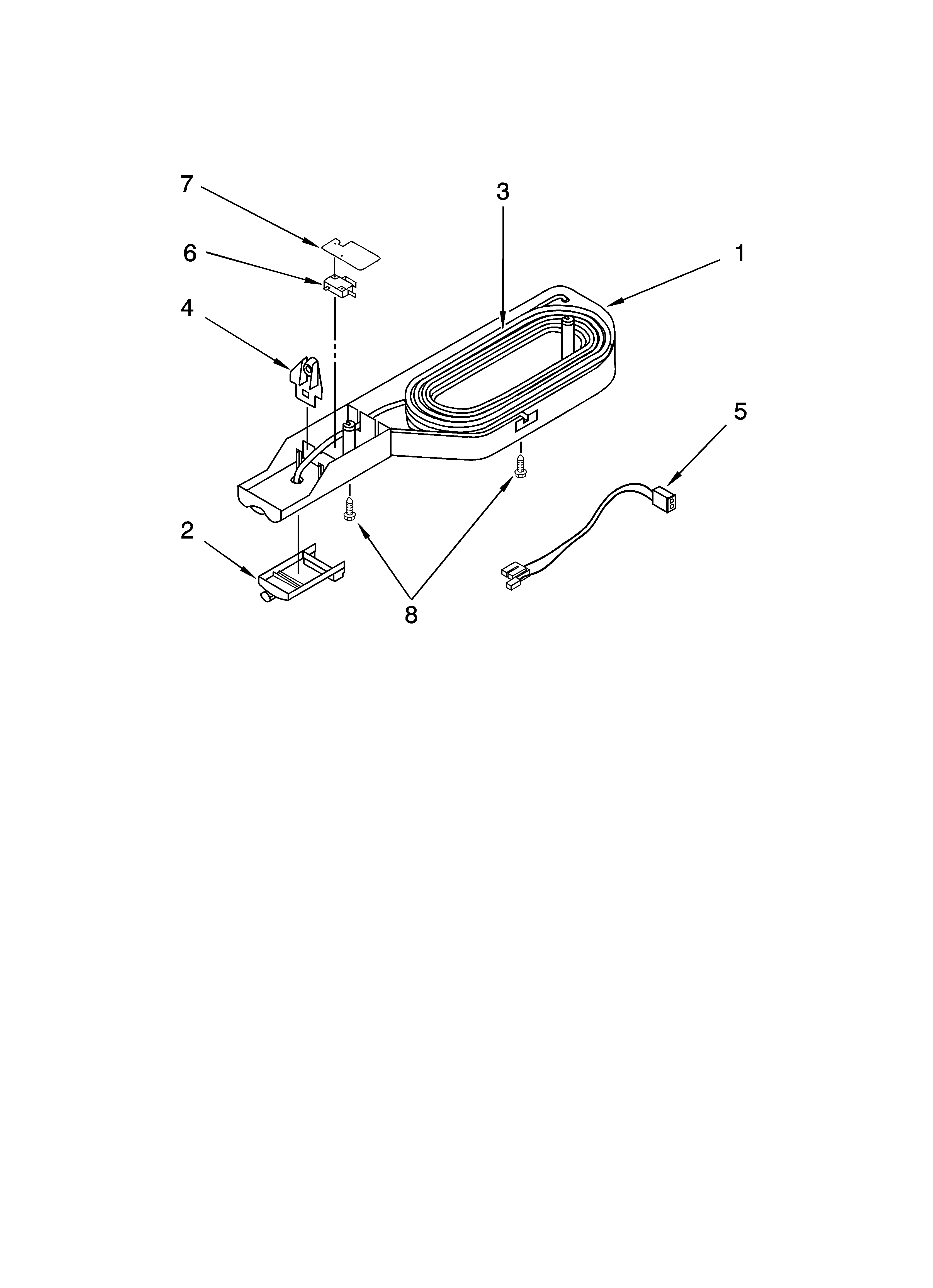

    Yours is a bit different, yours is in the console area.
    http://c.searspartsdirect.com/lis_pn...2019-00008.png
    Here's the reservoir for your model:
    Manufacturer's Number: 2320316

    Could you please explain further for me. Where is the console area? And how do I check my model 106-74254400 to see what's wrong with it not dispensing water. I ce maker works fine. There mfg #2320316 does not show my model. Thanks for your help.
  9. #19
    63,159
    ON your model its very difficult to get to, I'd advise Sears to come out.
