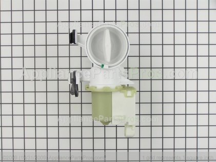

    I've had that same loud buzzing noise when my front loader HE3 110.42822201 would drain. Its the water pump going bad. I purchased my washer in May 2003.
    I just last night installed my 2nd water pump!!! Works great now. No buzzing noise!
    I've had $350 top loaders run for 15 yrs with the original water pump. Why did Sears / Kenmore / Whirlpool get cheap on these water pumps!!! I paid over $1,000 for this washer and I'm NOT a happy customer!
    I took apart the first bad pump and discovered the impeller shaft pulled right out of the pump with my fingers. Second one did the same.
    The motors on these pumps are made by ASKOLL in Italy. Art 294020 . Mod M75. 120 VAC. Intermittant duty 15 min on, 45 min off.
    What a piece of junk!!!
    $100 to replace the water pump every 2 years!!!

    Yea, I'm not sure why some pumps last longer than others, I've seen some customers HE3 models go for many years with the original pump, then others not last long. All I say to my customers is to make sure they check their pockets so small objects don't get in the pump impeller and break or jam it.
    Here's the water pump for the HE2 models(INSTALL VIDEO INCLUDED):
    Whirlpool W10130913 Drain Pump and Motor Assembly - AppliancePartsPros.com
    Here's the water pump for the HE3 models(INSTALL VIDEO INCLUDED):
    Whirlpool 280187 Washer Drain Pump Assembly - AppliancePartsPros.com

    Default Pump replaced solved noisy drainage issue
    I was skeptical but my washer was soo noisy that I was ready to scrap it and get a new one. now the washer is as quiet as a mouse. Weird cause the pump turned just fine and had no issues visually. I did have some debris issues early on in its history seems just about anything can get past the seals and end up in the little basket. I am assuming one of those debris did some unseen damage to the pump
    My advice is to empty and check the drain basket once a week or so and if its super noisy on draining then replace the pump really simple to do and cheap
