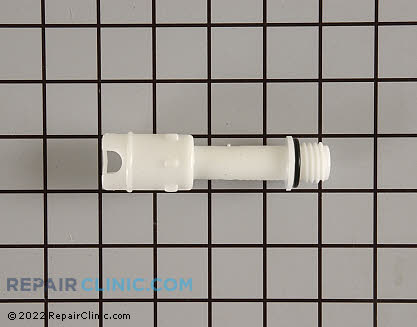

    I had the same problem on my ten year old Whirlpool Gold Model GU940SCGQ2: (An inch of standing water at the end of the drain cycle) Here is what I discovered that fixed my problem: At the output of the drain pump there is a small part called a "Check Valve" (PN 675238 on my machine). I am certain that ALL dishwashers have a similar check valve. The flexible drain hose connects to the check valve with a squeezable hose clamp ring. From there, the hose is usually routed a few feet higher, and then lower, to empty into your garbage disposal.
    You need to disconnect the hose clamp and drain hose from the check valve (drain pump output). When you disconnect the hose clamp, be prepared for a lot of water to drain out. (I used a large shallow pyrex pan to catch the water.) I then blew into the hose going towards the garbage disposal and discovered no blockages.
    Getting back to the check valve, it has an odd "V" shaped piece protruding slightly from the inside of the plastic cylinder. I was able to remove the "V" shaped piece, and discovered that it also had a round circle-shaped plastic piece attached to it. On the other side of this piece, inside of the check valve cylinder, is a small rubber circular flapper valve, (smaller than a dime) that is attached and doesn't come out.
    What I found on my unit was a TINY hairball and a short piece of hair or string that was caught inside the check valve, preventing it from fully closing. I then replaced the plastic "V" shaped piece inside the check valve assembly, and re-installed the drain hose.
    Here is WHY the check valve is important for this problem: When the pump finishes pumping the water out of the dishwasher and turns off, the water that is still between the dishwasher and the garbage disposal, drains back into the dishwasher through the partially open check valve. Finding and removing this tiny hairball from the check valve ended up saving me the cost of a new dishwasher!

    Yes, what I find on these models 95% of the time when it won't drain properly is the check valve clogged.
    There should be just a black rubber flapper inside that check valve, push something through it, like a pen, it should go through. Also flush it with water from your sink.
    Here's the check valve for your model:
    Check Valve 675238 Order now for same day shipping. 365 day return policy. RepairClinic.com
