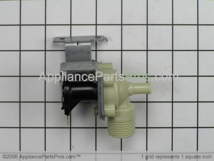

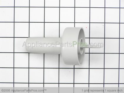

Results 1 to 6 of 6
Thread: Kenmore Portable dishwasher Not getting water
    Nov 2007
    santa monica
    Default Kenmore Portable dishwasher Not getting water
    Model Number: 665.17439001
    I have a few years old Kenmore portable dishwasher Model # 665.17439001 I hooked it up to the sink with the adaptor but it doesnt seem to be getting water to the dishwasher It turns on and runs it cycle but no water...please help
    Steve
    77,287
    Hi Steve,
    #32 here is your float:
    (click to enlarge)
Name:	P0206001-00003.jpg
Views:	244
Size:	67.9 KB
ID:	20088
    Check that first, move it up and down, you should hear a clicking sound.
    Your float may be stuck.
    Nov 2007
    santa monica
    Default Thanks Jake But...
    Thanks for sending me the info on the float I bought this dishwasher used It doesnt have the #32 float as in the diagram. It didnt come with one. Its missing. DO i need it? I was going to replace the Valve/regulator where the main water hose come into . It looks like its the first valve the hose go into from the fauset. Its on the bottom near the front Its white and is hooked on a metal bracket and has 120 v 60mz 7w writen on the bracket. it looks like its down around where 23-24 are. Any other Ideas please let me know
    77,287
    Yes, you definitely need a float.
    Here's the float for your model:
    Whirlpool 8519552 Float
    Here's your water inlet valve#20:
    Whirlpool 8274220 Valve-Inlt
    Nov 2007
    santa monica
    Thumbs up Thanks Jake...You really helped me!!
    It was the Float! Thanks so much I got it working and I have clean dishes... finally!!.
    THANKS SO MUCH!!
    STEVE
    77,287
    Good job Steve.
  1. Kenmore Portable Dishwasher leaking
    By WCPCR in forum Sears Kenmore
    Replies: 10
    Last Post: May 24th, 2014, 07:22 PM
  2. Kenmore Portable Dishwasher $200
    By downsizegal in forum Buy, Sell or Trade
    Last Post: September 24th, 2013, 06:00 AM
  3. Replies: 4
    Last Post: September 25th, 2011, 09:18 PM
  4. Kenmore portable dishwasher 665.17439001
    By saltwater143 in forum Sears Kenmore
    Last Post: August 21st, 2006, 07:22 PM
  5. kenmore portable dishwasher will not drain
    By beadedsweaters in forum Sears Kenmore
    Last Post: December 31st, 2005, 08:02 PM
