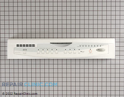

    My GU1200XTLQ1 Whirlpool Gold Dishwasher is about 5 years old and is just now giving me problems. The dishes don't seem to clean very well anymore, I don't think it completes a full cycle. The other day I opened up the dishwasher and it hadn't full drained (LED's blinking).
    Right this moment, the "Rinse Only" LED is blinking. Nothing happens if I press any of the other buttons, except for the "Cancel" button -- it just begins to blink in unison with Rinse Only. I tried turning off the power to the dishwasher for 60 seconds, but nothing happens -- it goes back to the blinking.

    My problem matches a note in the first link: "NOTE: If the line voltage is normal and a single Cycle, Option or Rinse Only light is blinking, the problem is usually a stuck or shorted keypad on the active overlay, not the control. A resistance check of the active overlay should always be made, using the keypad matrix in the product tech sheet, prior to replacing the electronic control.
    I am 20 years old studying mechanical engineering so I would like to fix this on my own and avoid ridiculous servicing charges. Is the problem the control panel? Where can I find the replacement part? How do I put the machine into service mode, etc?

    Yes, the problem is your control panel assembly. You'll need a new one.
    Here's the control panel assembly for your model you can order here:
    Touchpad and Control Panel 8534834 Order now for same day shipping. 365 day return policy. RepairClinic.com
    Its very easy to install, just turn your breaker off to your dishwasher, then remove the control panel screws that are mounted on the inner door liner. Then it will tilt out and you just disconnect the ribbon cable from the control board, then take the door switch assembly off and the control board also, they just unsnap.

    Thanks a lot Jake! I ordered the part and am waiting for it to ship. I'll post again after I install it.

    It works!
    Thanks so much, you saved me a lot of money!
