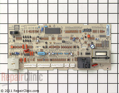

    Hi Aaron,
    You may want to check your main control board now for burned spots on it now.
    Its located at the top of your dryer, under the top dryer panel.
    Here's the repair manual for your Neptune Stackable you can print out: www.applianceblog.com/manuals/MaytagNeptuneStack.pdf
    Main Control Board WP22004325 Order now for same day shipping. 365 day return policy. RepairClinic.com

    Today was a rainy, quiet day and I finally had a chance to remove the Machine Control Board and examine it. Unfortunately, from what I can see, it looks virtually perfect. I don't see any scorching, burning or other oddness around the various components.
    I'm about to reassemble everything now and see if anything has changed.
    I'm attaching a link to detailed photos of the control board - front and back - if someone with a more experienced eye can glance and tell me if I'm overlooking something.
    http://www.halfpress.com/private-files/Neptune/
    Assuming I reassemble and the problem hasn't gone away (and I don't know why it would short of a loose connection I'm inadvertently fixing in this process)... any other thoughts?
    - Aaron
    77,038
    Hi Aaron,
    It looks good, but you never know, I've replaced the machine control boards when they look perfect like yours and it fixes the problem.
